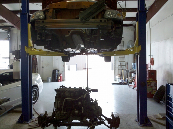

Well lost compression on #3 on my 2008 ss so pics will come
Spec stage 2 clutch
Spec flywheel
Ebc drilled rotors
Ebc green stuff pads
Arp headstuds
Wiseco pistons
Work will start monday
Head machined

Old Nov 6, 2010 | 09:28 PM
ssdivin's Avatar
Joined: 12-10-2008
Posts: 115
From: Houston

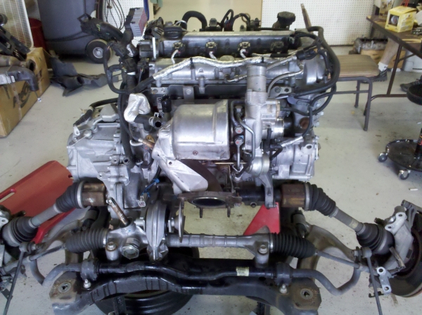

Old Nov 6, 2010 | 10:04 PM
ssdivin's Avatar
Joined: 12-10-2008
Posts: 115
From: Houston
Oh new turbo and intercooler ect ect
