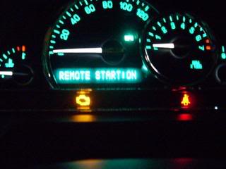

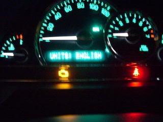

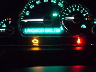

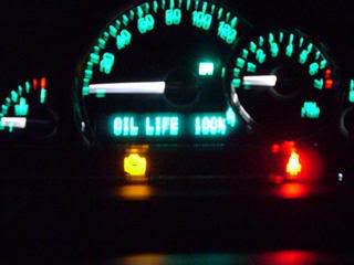

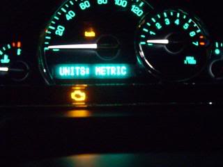

I was messin around today and found how to change the following:
1. language
2. kmh or mph
3. remoste start on or off
4. alarm beep when locked or unlocked
and other misc.
Turn to on position
hold down the info button on steering wheel
after a few seconds, release and then hit the info button again and you can then scroll though.
to change the presets you hold down the rest button and it will go through whatever options are available.
