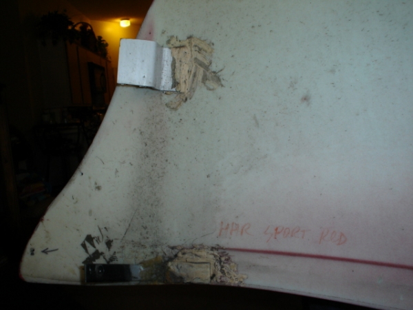

I waited to post this till I took skirts off for tire rotation..so here goes

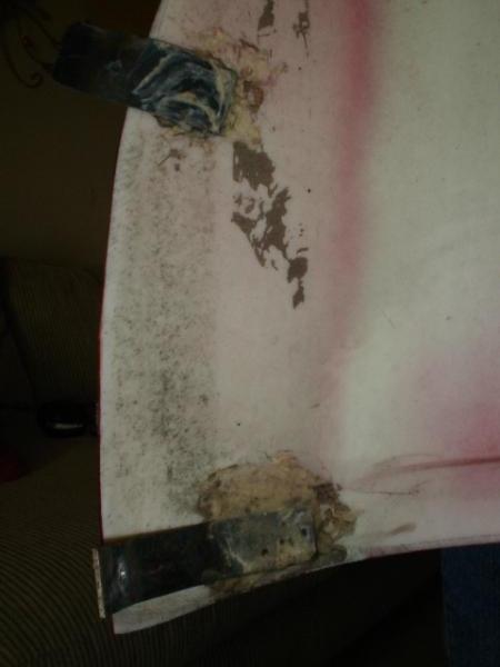

I got skirts from www.californiacruisers.com These ARE HHR skirts, obvious by the way the door is cut..There is a buyer beware thread on this site for you to read.. At the time, I wanted skirts and couldn't find another source..I was PERSISTANT and Bob answered by email..The issues were:
wait time, brackets placed wrong, had to be cutoff and reglued, one skirt had to be shaved to fit door, lack of instructions...

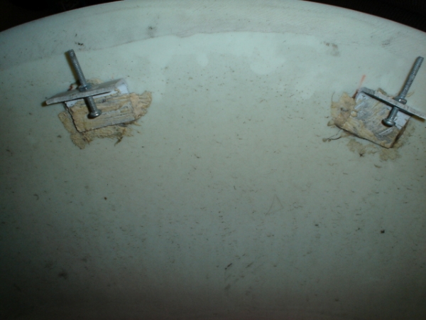

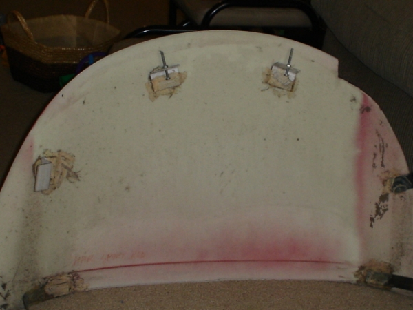

TOOLS; Phillips Head Driver, Air Cut Tool, Drill Bit to match screws in top brackets,
5/16 by 1/4 Socket, 1/4" Rachet, Permatex Permapoxy 5 min. Plastic Weld, Touch Up Paint =$10 from dealer
SCREWS; (per skirt) 2 top included, Bottom Rear = use hole and screw already there in well
Bottom Outside = 2 chrome self tapping included (I paintedto match)
Upper Front (by door, under rubber) = 1 chrome self tap included
Lower Front (inside fdr well) = 5/16, 1" L I purchased

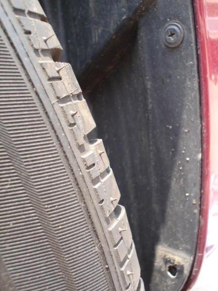

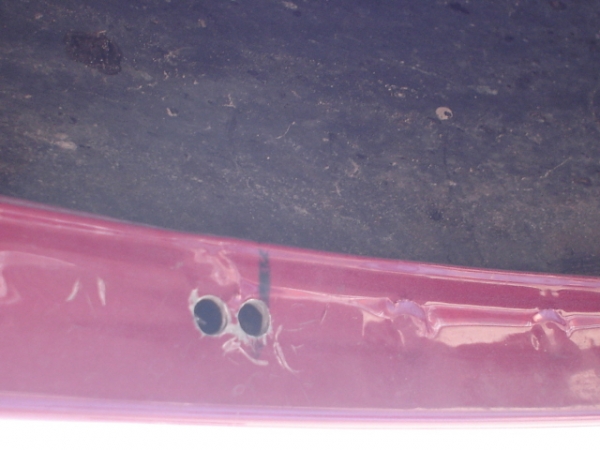

Start with car on rack or jacks/stands, 2 people, wheels off..slip skirt on, lifting up top two brkts w/screws over lip of well, placing clip (no screw) in rear indent of well...push up firmly from bottom and against top outside, spreading skirt out watching for tire rub...mark for drill holes..
I had to drill twice due to misplacement...measure twice, well you know
Put wheels and skirts back on & mark drill holes for lower brackets, lifting up rubber and sliding bracket under it.
Take skirt off and drill holes where marked, check for door closing and shave, smooth and paint edge of skirt if necess. (Only 1 of my doors needed it...
Bolt skirt on...secure back flare on outside with 2 chrome Painted to match..self tapping screws
First time is hardest...after that I loose estimate 2 hrs per skirt, total 4 hrs.

On this pic it looks like the cut for the door isn't very "round". Is the fit better than what it seems from this pic?

If I had a do over I would round it off some..but not really noticable to most...
You are right, should probably be a how to guide

I don't have the lowering springs yet...we have made some trips, pretty loaded and didn't have a problem...just have to watch out for obstacles and do frequent tire checks..like rotation this week...
We feel so naked without them....but while they are off I may try to smooth out the door area like mike said...it doesn't get stuck, but I think it can look better...??
