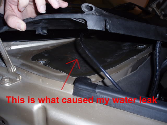

I took off the cowl piece under the wiper arms and saw the rubber piece that covers a big whole,
leaning in toward the passenger compartment, looked just like a funnel that was directing water that way.
Must have knocked it loose when putting in the new windshield.
That tar looking crap the factory put on it was dirty, so it couldn't be used again.
Pulled all that stuff off, cleaned it up, put a nice bead of black silicone on the rubber let it set a few minutes, put it back on the car pressed it down a little and dried over night in the garage.
Water leak fixed. ... Thought about taking pix after I was done..doah. This could have helped someone fix their problem. Maybe it still will.
Also, from it being wet, it blew my blower resistor.
Had to buy another one today:
cost = $44 from stealership
no more wet floor & blower works on all speeds = priceless

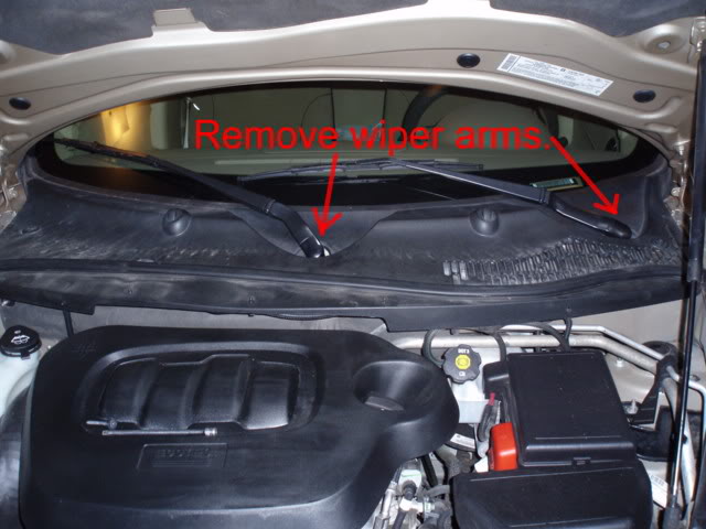

1. Remove the left and right wiper arms. Pop off the cover and use a 15mm socket to loosen the nut.
With the hood still up, lift the drivers side and it should remove pretty easily, the passenger side will be a little more difficult, I had to remove the blade assembly, but I got it off.

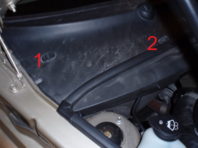

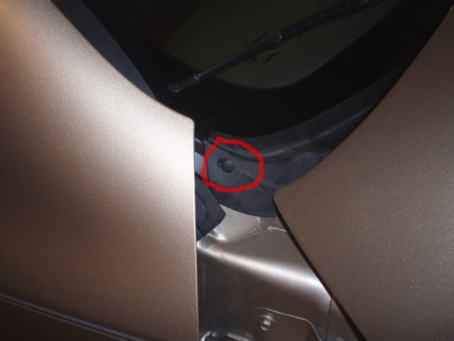

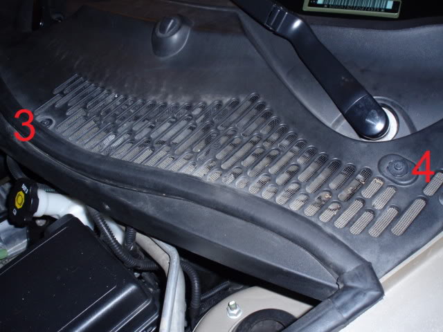

2. Remove the four 7 mm screws (be patient they are about 2.5 in. long) and the two push-in retainers from each side of the grille panel.

5. Then you will see the patch that was causing my problem.
6. I removed the butyl patch and cleaned the area with sticker remover. On the car and on the butyl patch.
7. Ran a bead of black rtv silicone sealant around the patch, let it sit about 3 minutes then reinstalled on the car and pressed down around the edges to make a better seal.
