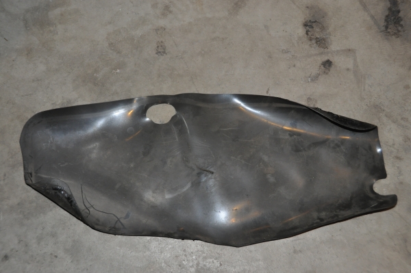

My old Budy patch- I replaced it with clear plexi-glass and a silicone sealer.
I just bought a 2006 recently that must have been garaged, first rain today and the passenger floor was holding almost 16 oz of water. After wet vac I pulled the cowl, Had to laugh, the "water deflector" as it is described by Chevy wasn't even there. Just a big ol gaping hole!
What thickness plexi did you use? None of the local dealers has the patch in stock and I was thinking the same.
Old Sep 15, 2015 | 09:37 PM
  #93
Posts: 11,721
Plexi glass, sheet metal or just about any rigid, durable material should work.
Point being, to cover the hole and seal it up with a quality sealer.
