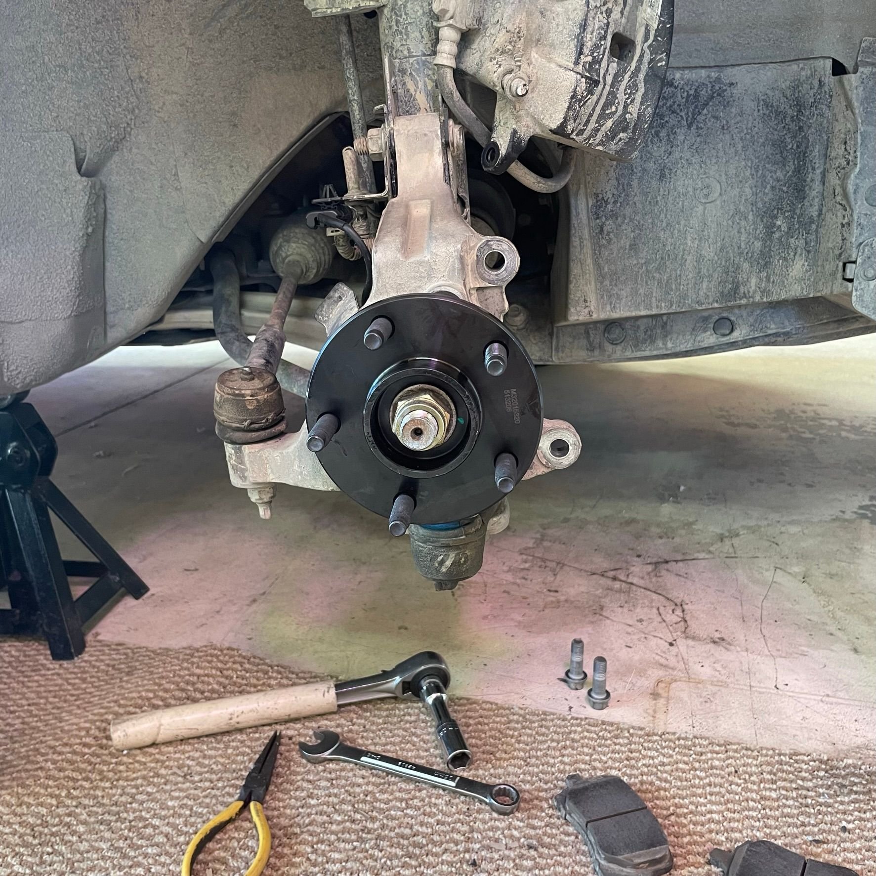

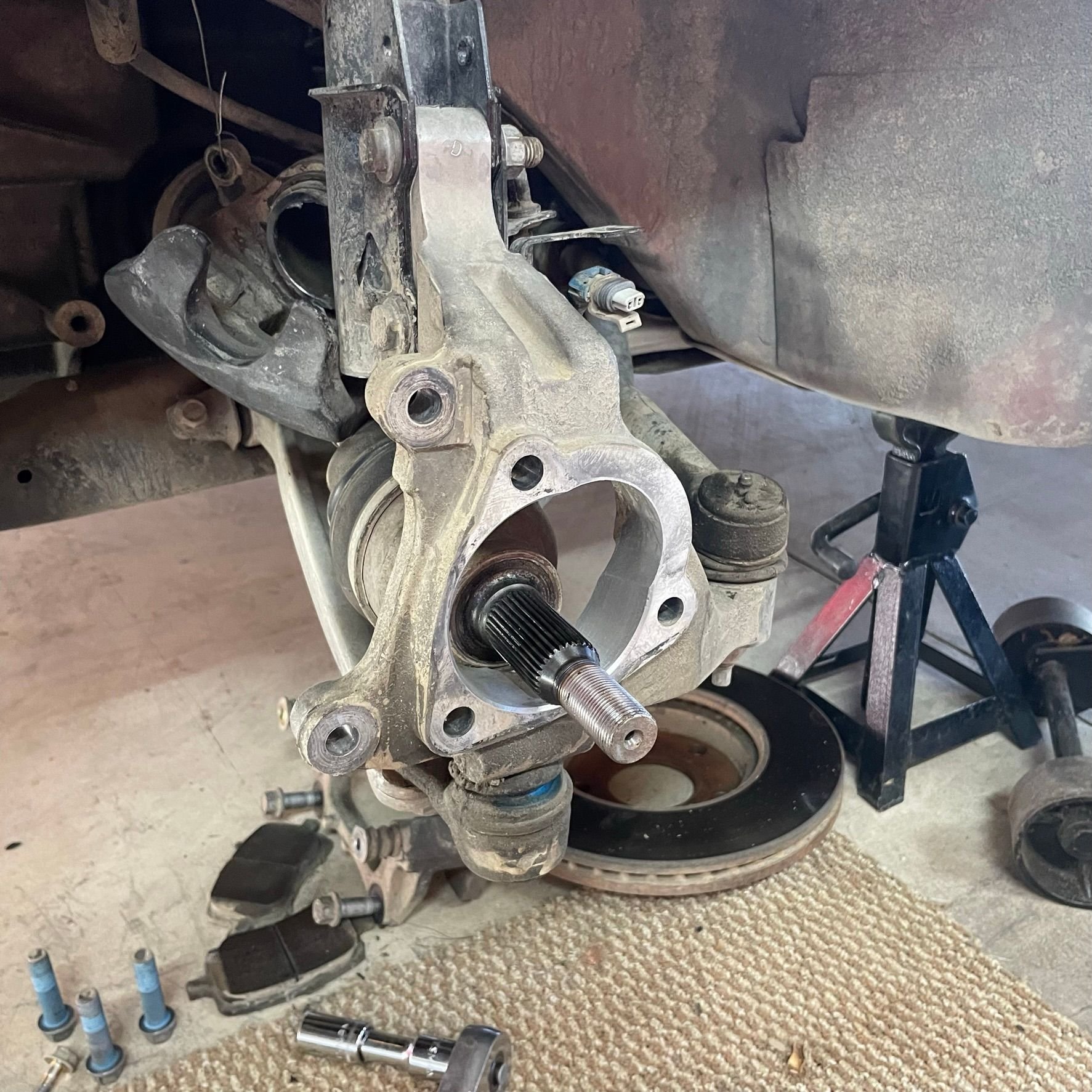

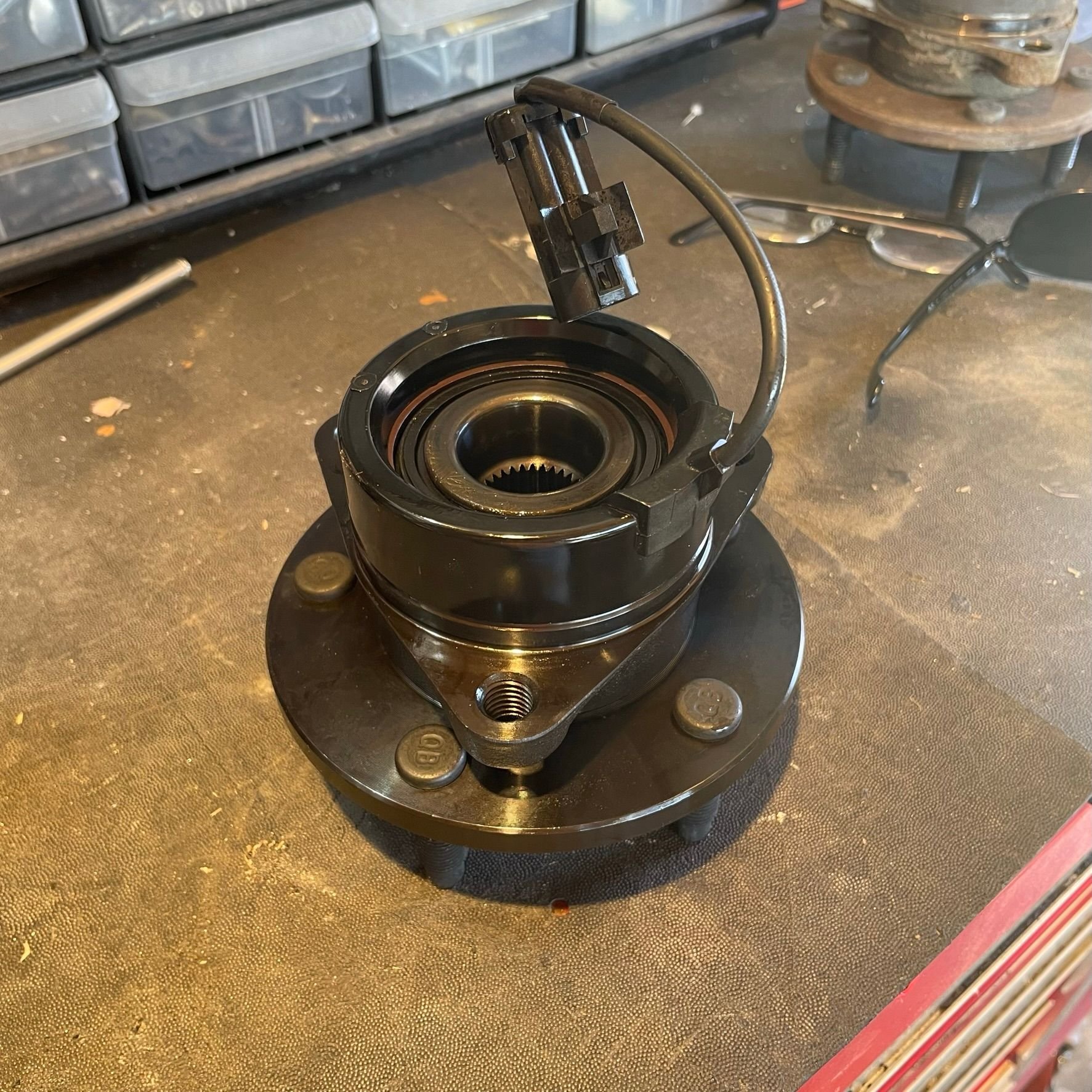

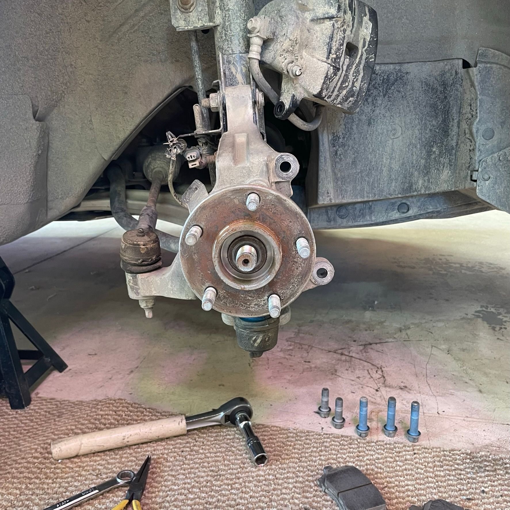

If you're getting an ABS or Traction Control Warning, there could be a problem in the hub or the wiring in the harness. The front hub is easy to replace, about the only difficult part would be getting the old hub loose from the steering knuckle if you live in a salted roads area.
Remove the tire, remove the caliper, remove the caliper bracket, remove the disc, disconnect the harness, remove the 3 bolts that hold the hub in place, remove the axle nut, then remove the hub. Installation is the opposite of removal. Torque all bolts to spec.
