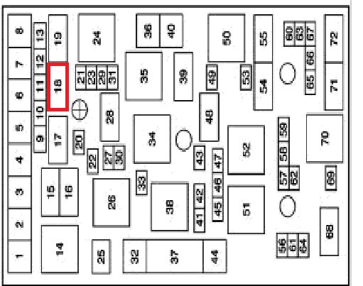

Hi
My gate stopped opening - electricity does not flow to the lock.
I can open the gate by a screwdriver, but I have to restore the electric lock function.
I think one of the fuse has died. I began to look. I read the instruction, relay No. 18 - the only thing that is more or less similar to the potential object of research.
I doubt because I do not trust my English. In addition, I do not know much about electrical devices. Electricity is a Chinese alphabet for me.

18 Liftgate Release

In my 2009, there are 9 relays of that same part number. Have you tried swapping with another relay?
Old Apr 22, 2017 | 03:28 PM
  #40
Posts: 26,533
Fuse #10, be sure NO fuse in #11.
