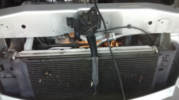

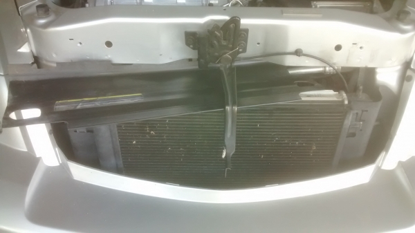

5. You'll have an easier time if you remove the horizontal shroud over the radiator. there's a bracket on each side(outside the engine bay), attached with a 10mm bolt. Take the brackets off, and work the shroud out towards the passenger side.
Now that it's out of the way, you'll be able to get to a few things easier.

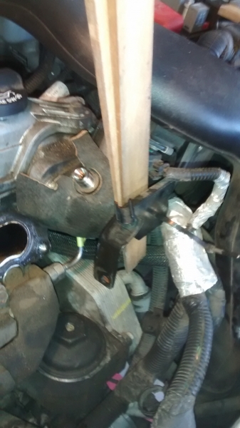

7. Similar situation on the passenger side for the dipstick tube. I had a heck of a time finding this bolt. This time there was a zip tie anchor, you can cut it if you wish, and replace it later, easier than extracting another Christmas tree anchor. The bolt is near the center of the pic. Remove it, 10mm and u-joint. This view is between the radiator and support.
