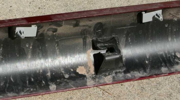

I am posting 2 more pictures of the removed molding, as the instructions just say to remove it, with a reference to a GM operation which we don't have.
The top picture is of the back of the drivers side, front to the right, sill molding that must be removed. The top clips (green) pop out by putting a wedge between the body and the molding and prying outward.
Note: no metal prybars, screw drivers, etc. Use a plastic wedge or a piece of wood. The way I did the drivers side was to remove the 2 screws (see above blue arrow) then from the front pulled the molding away from the body. It bent and twisted, but then relented and came off.
The blue arrows point to the 2 screws that need to be removed in both wheel wells, and the bottom arrows (red) point to the locations of the sliding brackets that are suppose to slide forwards. As I stated in my original post, they did not slide, and several ended up broken when I showed it who was boss. If they break it doesn't matter as they won't be used anyway.
Plan on installing them this weekend, so any pointers on a non-metal wedge would be greatly appreciated.
My husband installed ours a couple weeks ago and he did not use a wedge he just pulled realy hard, yes it did brake some clips but they are not needed anymore.. Good Luck
it took him about 2 1/2 hours to 3 but once he got one side done the other was easy only took him 15 minutes.
