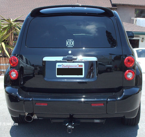

Originally Posted by afs9
If you go down to I think #47, you can see a pic Kim's SOM without the wiper.
https://www.chevyhhr.net/forums/show...t=15323&page=2
And other pix of my my blackie, & don's white HHR
and mine :)
