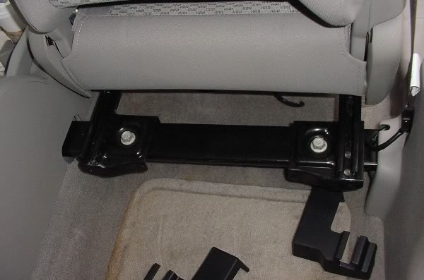

PASSENGER SEAT REMOVAL
Slide the seat all the way forward.
there are two plastic covers that conceal the two seat bolts.
These just pull off by hand. Grab the front edge and pry back, to reveal the two seat rear seat bolts:
remove the two bolts from the seat tracks. They are 18mm. The front just slides in to 2-channels per side, so you can pivot the seat UP and reach the electrical connections. Un-plug these(2)
The cool part is, that's it. The front of the seat is attached in the two channel slots. Just slide it back and UP and the seat is free. I recommend you completely fold it flat to make it easier to get out of the door opening. What you have left is a large black support beam that the seat is bolted to.

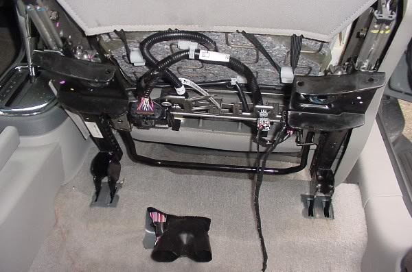

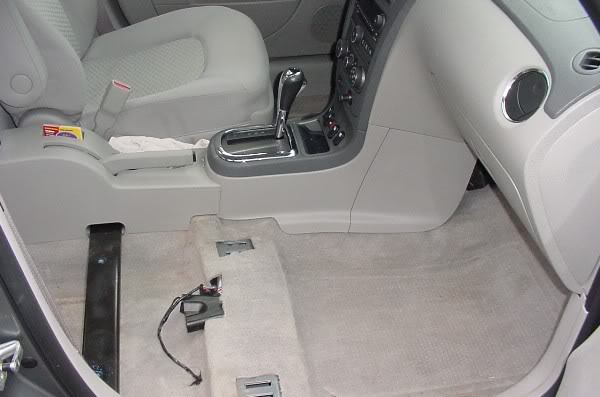

First, we'll talk about the carpet. You'll have to un-clip the top of the rear part of the console. Then slide it up and around the parking brake handle, with the parking brake handle UP. Now you have access to the console hold-down nuts and bolts. they are 10mm. There are two nuts that attach the front of the rear part of the console to the shifter housing, and two nuts that attach the rear part of the console to two verticle studs. Remove these. Un-plug the rear 12v power socket, and remove the rear part of the console.
next, you can remove the large black cross-brace that the seats attached to. there are large bolts on the outer end, and two large nuts under the center console area. Once these have been removed, you can remove the cross-brace from the car.
Next, remove the front kick panels, side sill panels, pillar trim panels(remove lower seat belt bolts-torx) and the rear sill plates. Now you need to lift the carpet and feed the front seat wiring through the hole to prevent snagging it. Remove the carpet by working it out from under the shifter housing part of the console, and roll it back towards the rear. I dragged it out the hatch.
vaccuum any dirt/loose debris, and check all the factory wire looms to make sure they stayed in place.
install the new carpet by following the reverse procedure. Take your time...make sure you remember to feed your front seat wiring through the access hole. Getting the new carpet under the rear trim panels can take some patience. If all else fails, you will have to completely remove the rear panels, which is alot more work. I actually removed the rear side seat belt lower torx bolts to make lifting the rear trim easier.
Once the carpet is in place, re-install all the trim pieces. be carefull to line up all the clips. especially the sill plates. Once you're satisfied, install the cross-brace, and the console, remembering to re-attach the 12v socket's wire connection.
that's it. Revel in your glory.

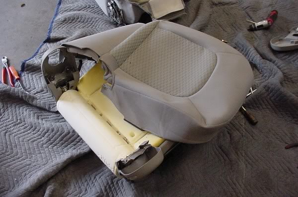

start by folding the seat down completely, and removing the headrest.
next, remove the button that covers the arm rest attaching bolt. Remove the arm rest.
next, remove the side trim, and seat belt buckle off the seat. The side trim is held on by clips, with a philips screw at the back of each piece:
You have to carefully remove each rear recline/forward knob. These can be tricky because they are held in by a tab that locks to the plastic as it slides on. Slide a thin screwdriver down the arm the knob is on to release the tab. If the tab breaks, it's ok...just use some RTV silicone to re-install. That way it isnt permanent, but strong enough to withstand use.
I did not remove the side corner trim completely, as it is felxible enough to allow access to the seat bracket bolts.
Next, remove the rear panel from the back of the backrest. It is held in with two push clips in the bottom corners. Use a panel clip removal tool to gently pry UP on the bottom corners of the panel. Once un-clipped, slide it back towards the bottom of the seat, and it'll come off
Now you have to remove the headrest plugs. These are LONG tubes that have extending tabs at the top to lock them in. Lay the backrest down flat, and look up into the back of the seat to see what I mean. You need to use your pincer pliers(or a long set of needle nose pliers) to compress the locking tabs, and use the panel removal took to work them up out of the seat just far enough for the locking tabs to disappear inside the tubes. Now pull them out by hand, taking note the position of the adjusting one for adjusting the headrest height.
Here's what they look like when removed. Notice the pincer pliers.
Now look at the exposed area of the back of the seat's backrest.
take note of the position of the cross beam bar that attaches both reclining mechanism/springs. This is the same position it needs to be in when you re-assemble the seat.
Un-bolt the side brackets from the back rest, and set the bolts, and the one recline bracket aside. make a mental image as to which piece went on which side. One is definately marked R for RIGHT.

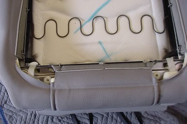

you will now see all the hog rings that attach the backrest cover to the seat.
Dont cut the hog-rings off. Use the side-cutters to grasp them, and twist them off. if they get cut off, you'll spend eternity chasing the half-clipped pieces off the attaching cables, and this is not fun. A few will break, but twisting them off saves time.
Parts of the cover are held on with slide-channel plastic...just remove them by hand, or use a curved awl to help walk the channel off the metal frames.
Once the bottoms of the seat covers are free from wrapping around the seat frame, start turning it inside out. You will find more hog-rings that attach some of the seating area seams to the seat's foam support. This keeps the seat covers taut, and prevents them from moving around, giving the seats that nice tight look. Just manipulate the foam out of your way, and twist the hog-rings off. You'll end up with a bare seat when done.
go back and make sure there are no broken hog rings left in the channels of the foam, or they might come back to haunt you later and damage your seat covers.

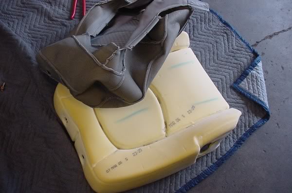

I found the date stamped on my seat foam...March 7, 2006.
Now match up your new seat cover with the old one to make sure you are installing the correct cover on the coresponding seat.test fit it FIRST.
Flip the cover like it's inside out. and start with the hog rings. Work from the center part of the seat, towards the outside, and then back, pulling the seat cover towards the back as you go to make sure you get no wrinkles. The cables that the hog rings attach to inside the seat foam seams allow the hog rings to slide back. They dont have to be crimped tight, just closed. as you wrap them around to the bottom, that's what holds them back and tight. Dont forget all the seams.
wrap the cover around to the back, and fasten the hog rings and locking channels.
re-install the head rest tubes, and observe the finished section.
You basically do the same thing as above for the bottom cushion.
re-assemble the seat assembly.

REAR SEAT ASSEMBLY
start by laying the seat as it would sit folded down in your car.
on the back plastic panels, there are 4 small plastic covers that come out. Use your little pick tool. Below them are philips screws. remove these:
then carefully remove the plastic panels and set them aside with the screws and screw covers.
remove the 4 bolts that attach the main part of the frame to the BACK of the rear seat's backrest.
pivot/roll this part of the frame back away from the seat.
