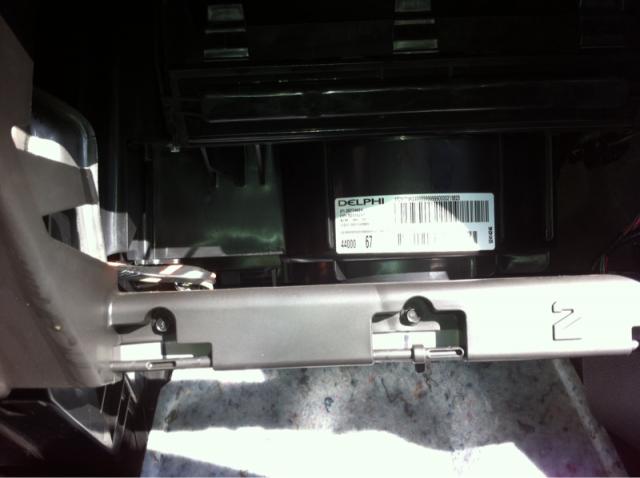

Replaced the heater blower fan on Sunday. What a PITA!
I was cursing GM for asking me to cut the fan cup with a utility knife. Taking a knife to the car scares me.
Attachment 15706

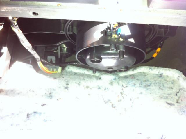

After removing the glove box
Attachment 15707
You can see the bottom of the fan cup that has to be cut out with a knife. Really hard around the back where the floor gets in the way.
You can also see the sound shield hanging down below. I augmented this with a layer of MLV and then a bunch of 3M sound batting left over from my doors. Makes the fan much quieter.
Attachment 15706
Attachment 15707
