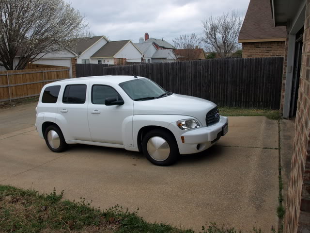

Thanks for the info
NG8650, How do you like the ride now?
I put the Goldline springs on mine and Solstice wheels and I love it. The car rides soo much better smoother and corners better.
Thanks, Curly
