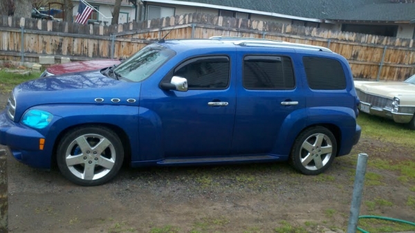

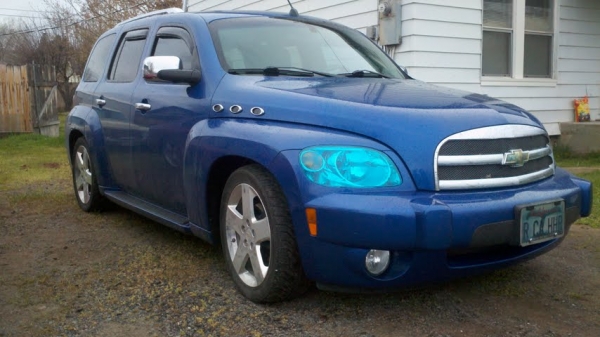

I installed the kit today and like it, though I think I was lied to about the GEN of my goldlines, or more likely the member I got then from just didn't know which they were.
They were supposed to be Gen 1, but the rears were pretty much identical to the levelers I removed to install these. I didn't bother measuring before and after, but the front dropped quite a bit and I love it, I just wish the rears would level out and meet the front. Did the Gen 2s leave it with a slight rake? Gen 1s lowered and leved correct?
here is a pic of the levelers I removed next to the (supposed) lowering rears.
Here is a pic of the car after the kit was installed, I know its filthy, but winter really isnt over here yet and I traveled alot Fri and Sat.
It looks more level in the pic than it does in person, maybe Im parked in a low spot.
I must say it rides nicer than stock ft, leveled rear and almost no body roll noticed when I took a few 15mph corners at 30 to 40mph on my test drive.
Apologies for the quality, but they are cell pics.

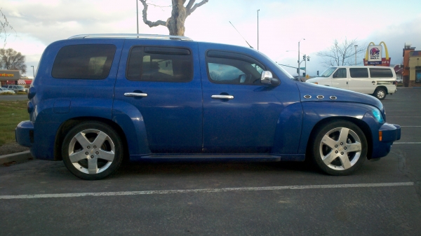

It looks that way in the pic but they were pretty much the same when I measured them, the lowering rears (on the right) do have almost a full extra coil compared to the levelers (left) but I was guessing the load rating was different so I put them in.
Here's a pic on level ground, its got a bit of stink bug to it for sure. Any suggestions?
