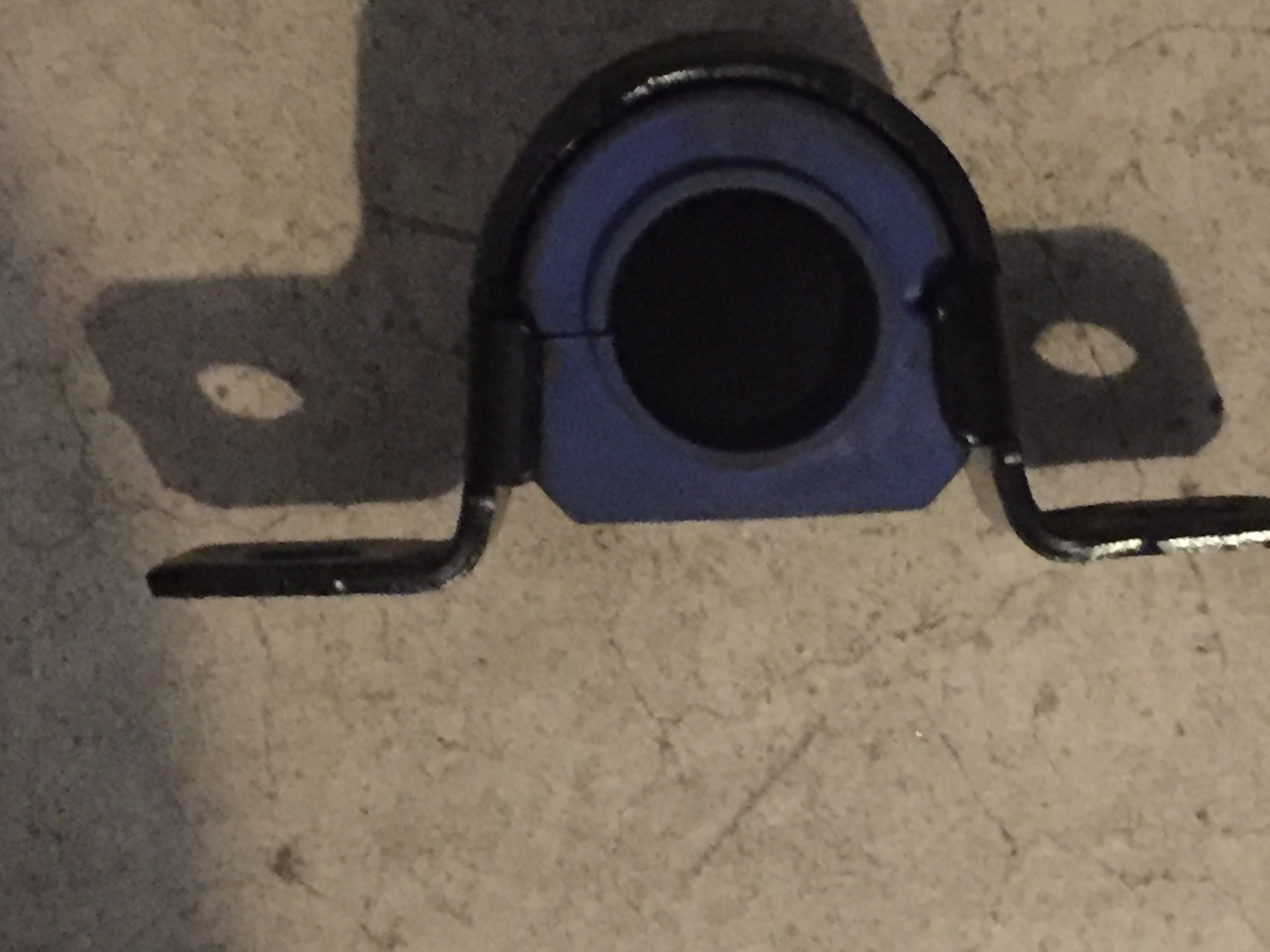

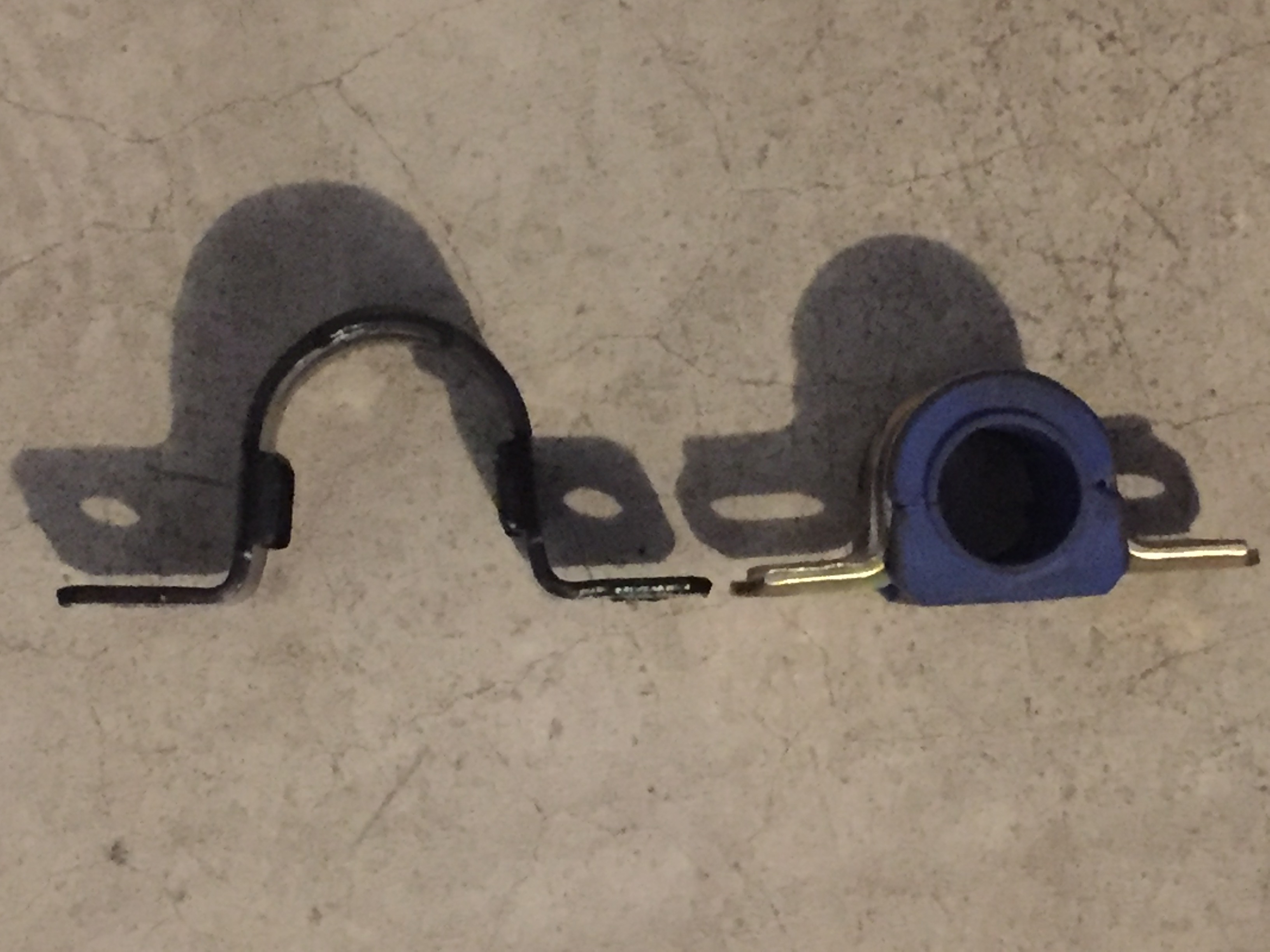

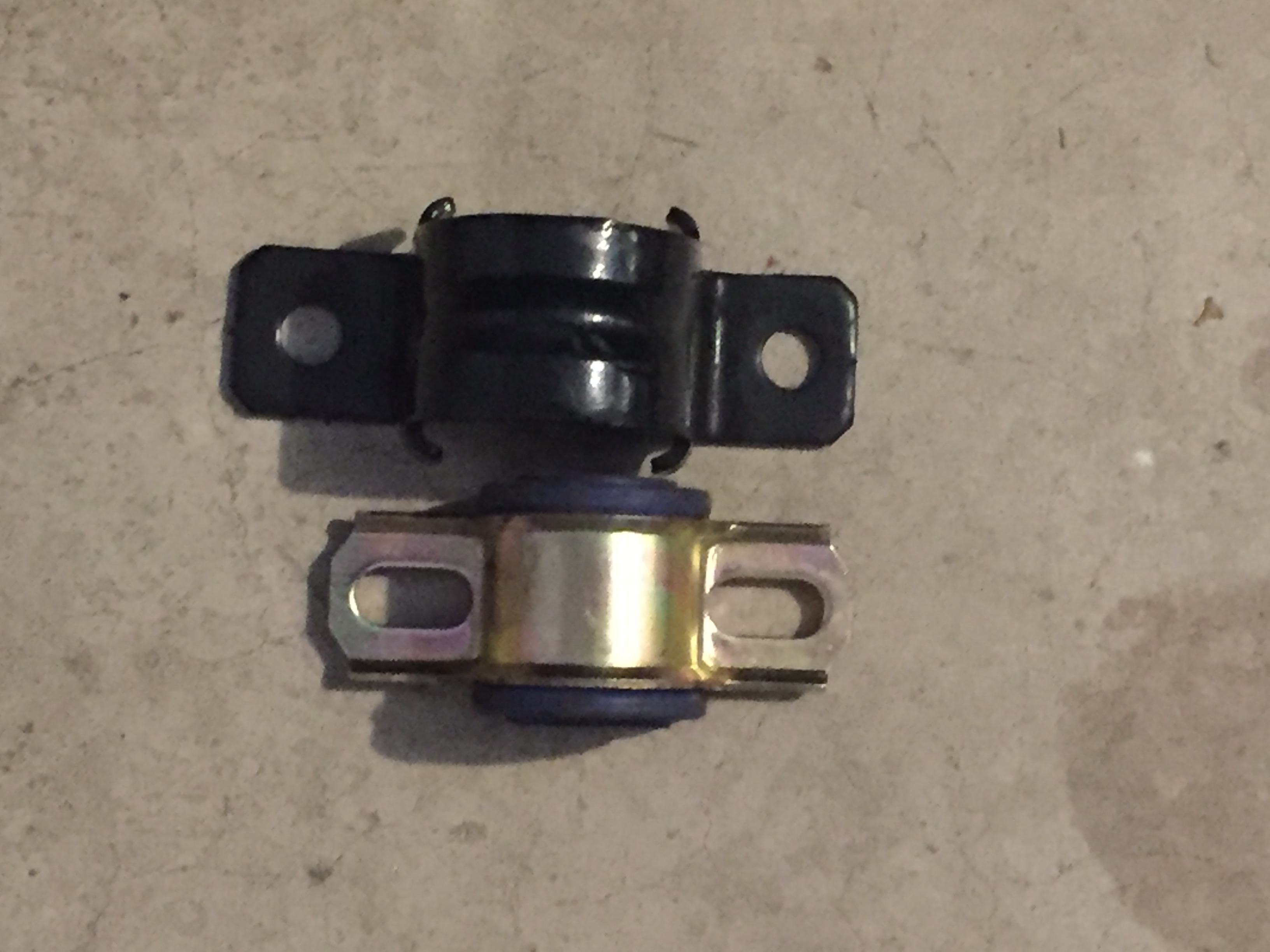

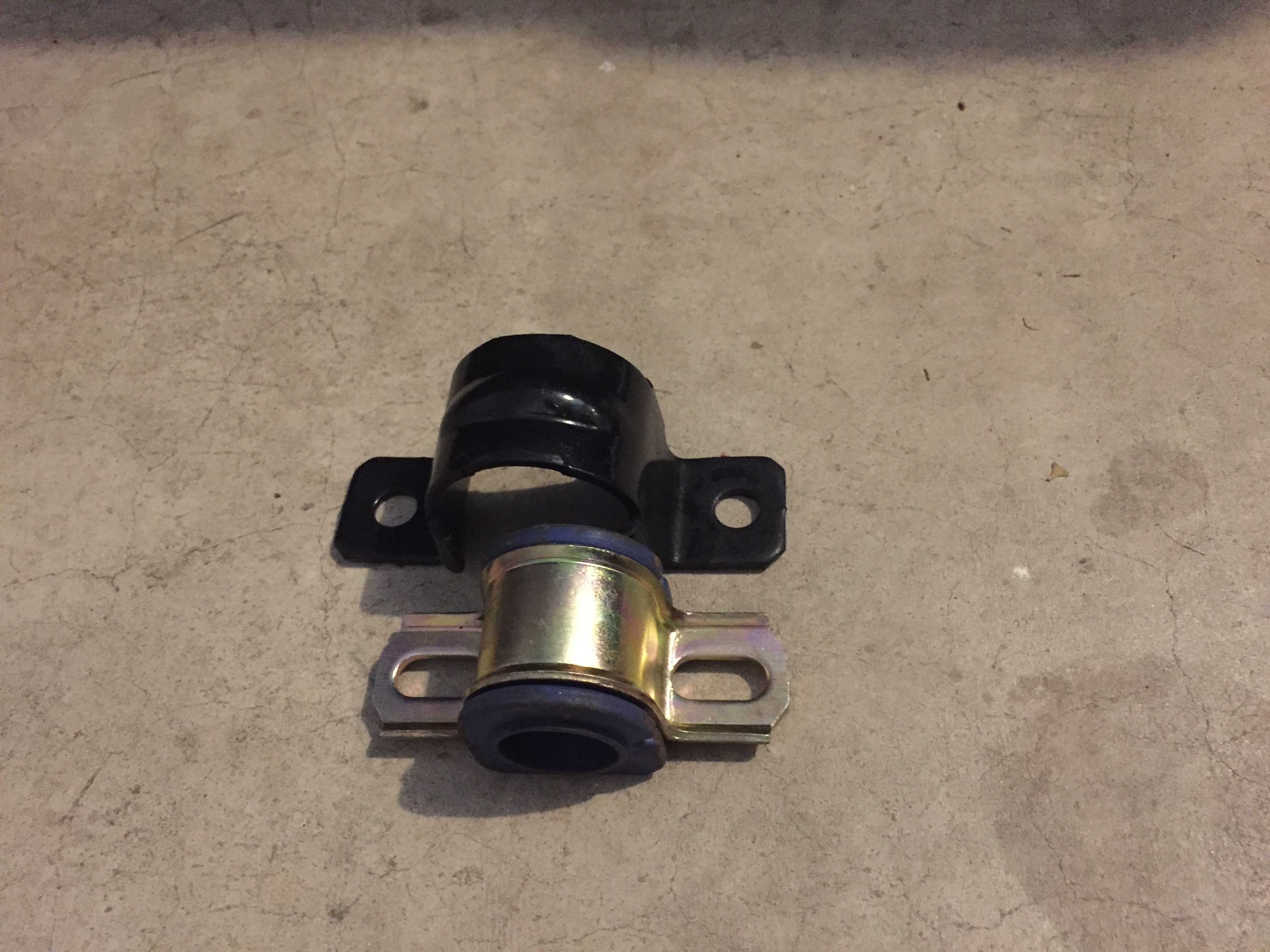

Old Aug 30, 2017 | 09:11 AM
Posts: 39,986
Well, I got the OEM brackets (black bracket)and the Moog K90400 bushings (blue bushing/gold bracket)
Seems a bit difference in size , so no these won't work without some fabrication!.
Hannibal, get the torches!!
Attached Thumbnails Sway bar bushings?-img_0711.jpg   Sway bar bushings?-img_0712.jpg   Sway bar bushings?-img_0713.jpg   Sway bar bushings?-img_0714.jpg   Sway bar bushings?-img_0715.jpg
Old Nov 5, 2017 | 10:06 AM
Posts: 39,986
Alrighty then , on Thursday, I had my wrench Dan over to swap out the starter, quick job, he hates the top bolt too!!!
We discussed replacing the swaybar bushings, we wound up using the new brackets with the old Energy Suspension bracket bolted down over top, there was so grinding and and fitting to be done, but they are in now.
Yesterday we went for a drive out to the country for eggs, bumps and train tracks involved, no more bumping in the floor boards on uneven asphalt or those tracks, the red polyurethane parts were cracked and very aged looking but not destroyed.
The swaybar doesn’t move by hand anymore either.
