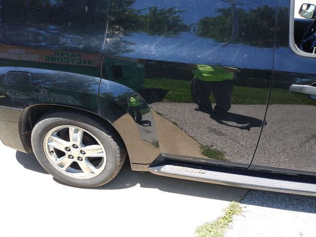

So, I thought about how much lower I would want to go, and how is the ride loaded with the FE5 SS HHR springs.
I cut up all the scrap lumber from the old deck surface, hand railings , and watched the rear slowly squat down just a bit, I’m off to the wood recycling centre and I’ll measure it loaded and then unloaded. I’ll ask for the weigh scale tickets to confirm how much those springs take.
Loaded down to 26 inches at the wheel arch
And back from the dump,
Gross weight. 1,870 kg. 4,122.8 lbs
tare weight. 1,565 kg. 3,450.2 lbs
wood weight. 305 kg. 672.4. lbs.
Loaded up going to the wood recycling centre
Back up to 27 3/4 inches.
SS springs handled the weight very well and handling was great, no bottom out or bounce over train tracks
