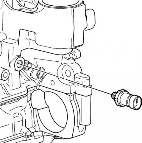

Here is a diagram of the oil sender. It is just above the starter. It's fairly easy to change out with an oil psi socket. You can rent one from most local part stores.

OK, I got the sensor changed out yesterday. It can be done from the topside of the engine, just getting the connector off the sensor was rather difficult (tight area, only one hand, everything coated in oil). It required a 1 1/16" socket to remove. It would be easier to get it from under the engine, once the starter is removed. I couldn't get the car up high enough to get at it from there though. Now to steam clean the engine and make sure it doesn't leak anymore.
