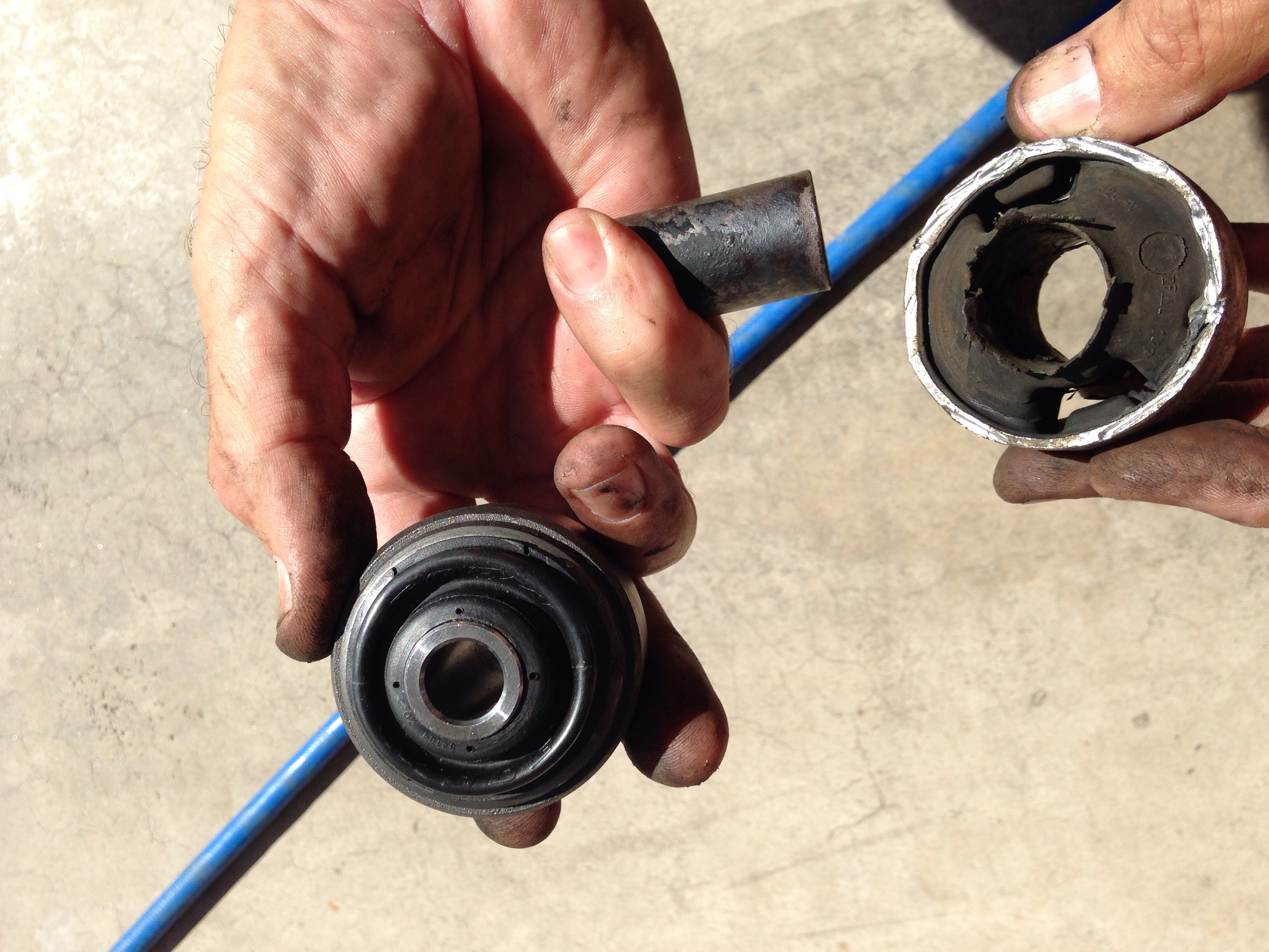

Her name is Serenity w/ 107k miles 06 sunburst orange LT 2.4L, she has clunked for for the past 7 years. The dealer has repaired it twice to no avail. Now my husband has maybe found the problem thanks to y'all. The sway bar bushings are worn and bumps, felt on the floor pan.

Check those lower control arm bushings also!
The one on the left is a new Moog K200792
http://www.moogproblemsolver.com/moo...ings_Sheet.pdf
The one on the right in pieces is the GM replacement I put in 4 years ago!
