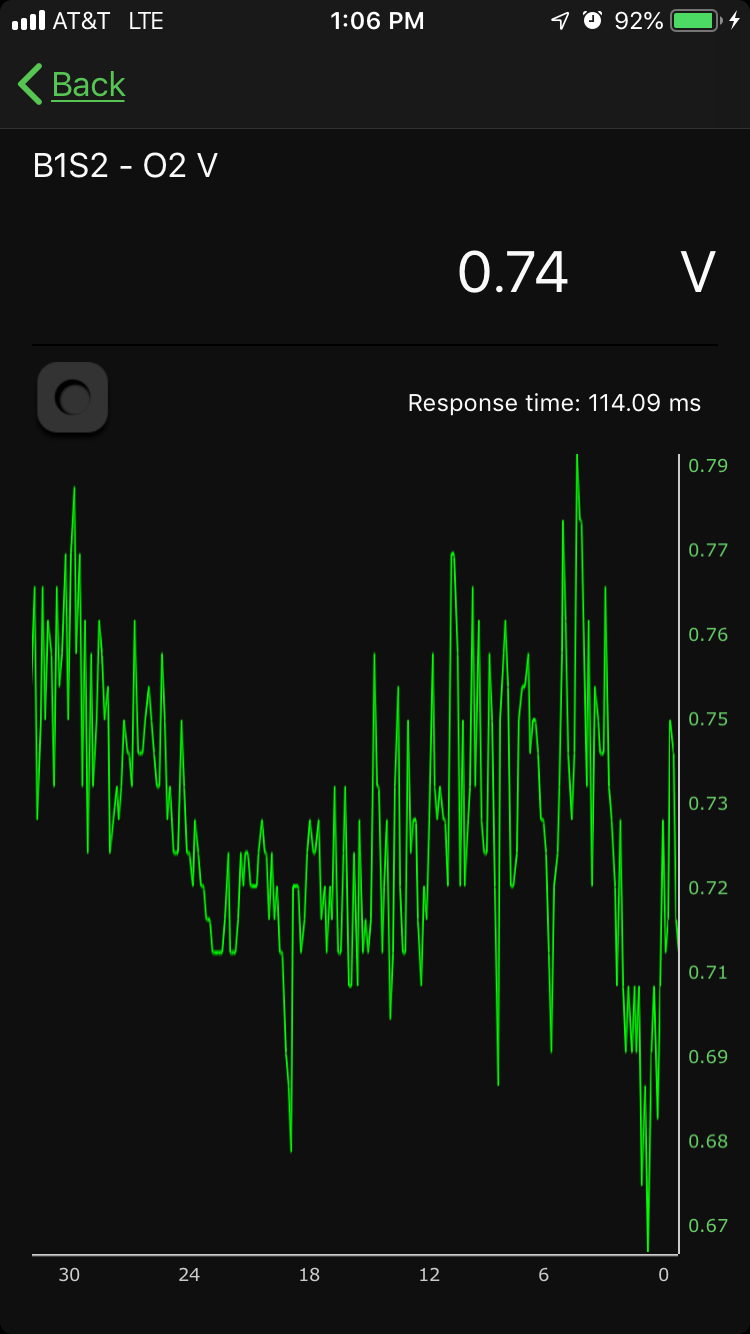

I am wanting to convey this for anyone else who may read this post and have similar issue
so today while driving on US19 around 50-60mph for 10-15 min with occasional red lights, finally came to a light where the car decided to run crappy while waiting for the light to change.
previous stops were all smooth. As soon as it cleared itself on it's own, the CEL came back on - p0420 code.
Prior to that i had the scanner running and took some screen shots of the 2 O2 sensors. #1 did as described - fluctuations. #2 stays fairly consistent around .65-.80V but more often a closer range staying in the .7X V
last pic is the MODE $6 readout with 'failure on catalytic bank 1'
I'm wondering if it might be a few things going on - none apparently causing mpg issues or overall performance issues... for now... but I'm guessing it can't be good long term and something will fail
#1 O2
#2 O2
#2 O2
RPM @ 55mph
#2 after car threw 0420 code and CEL came back on -
goes along with the p0420 code
