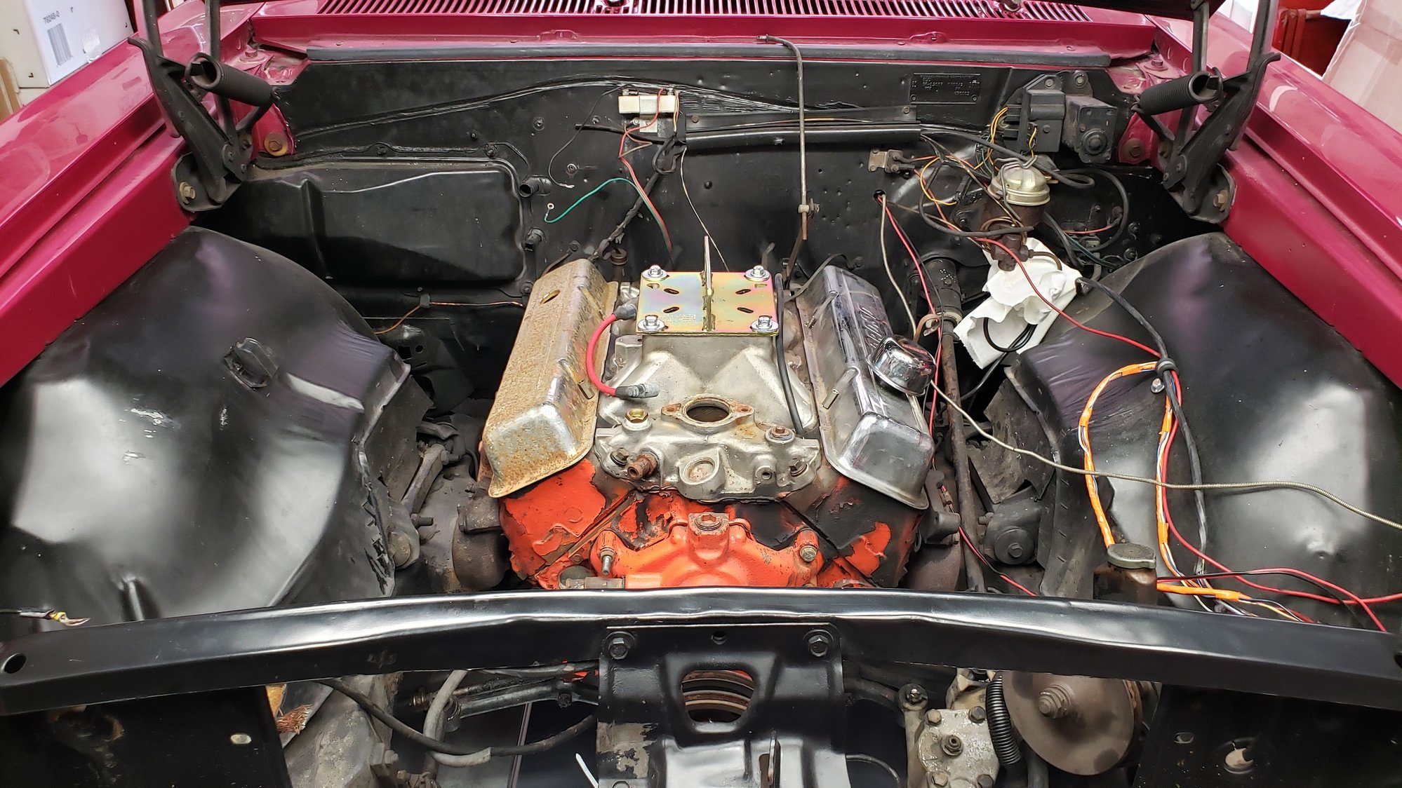

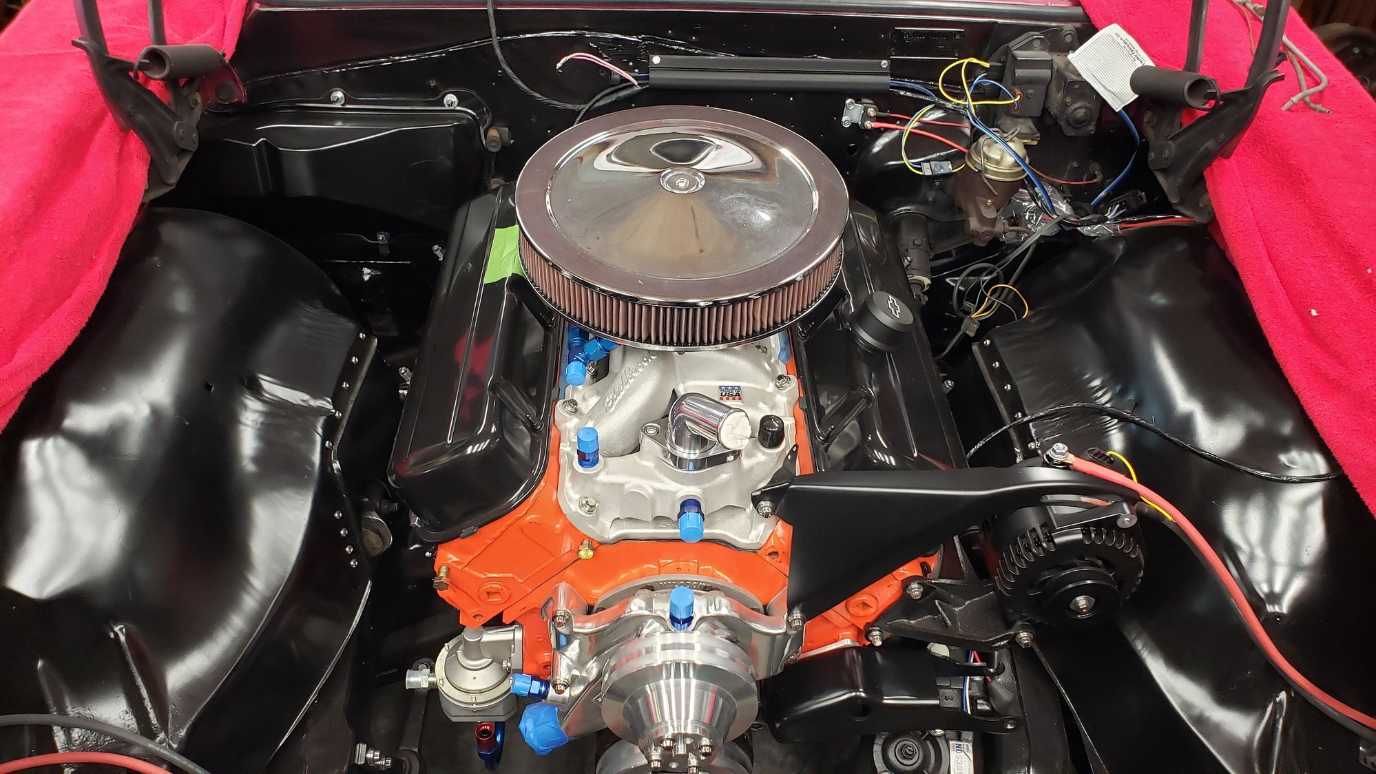

Still working on the Chevelle as well. its front end is horrible. itll need all new stuff too.
Pics to come on both rigs.

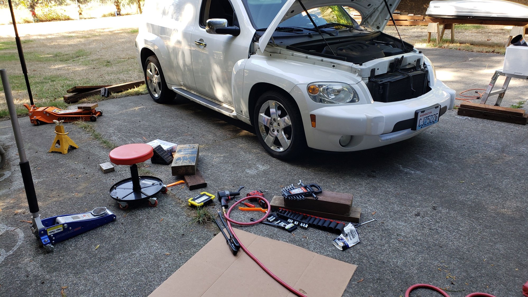

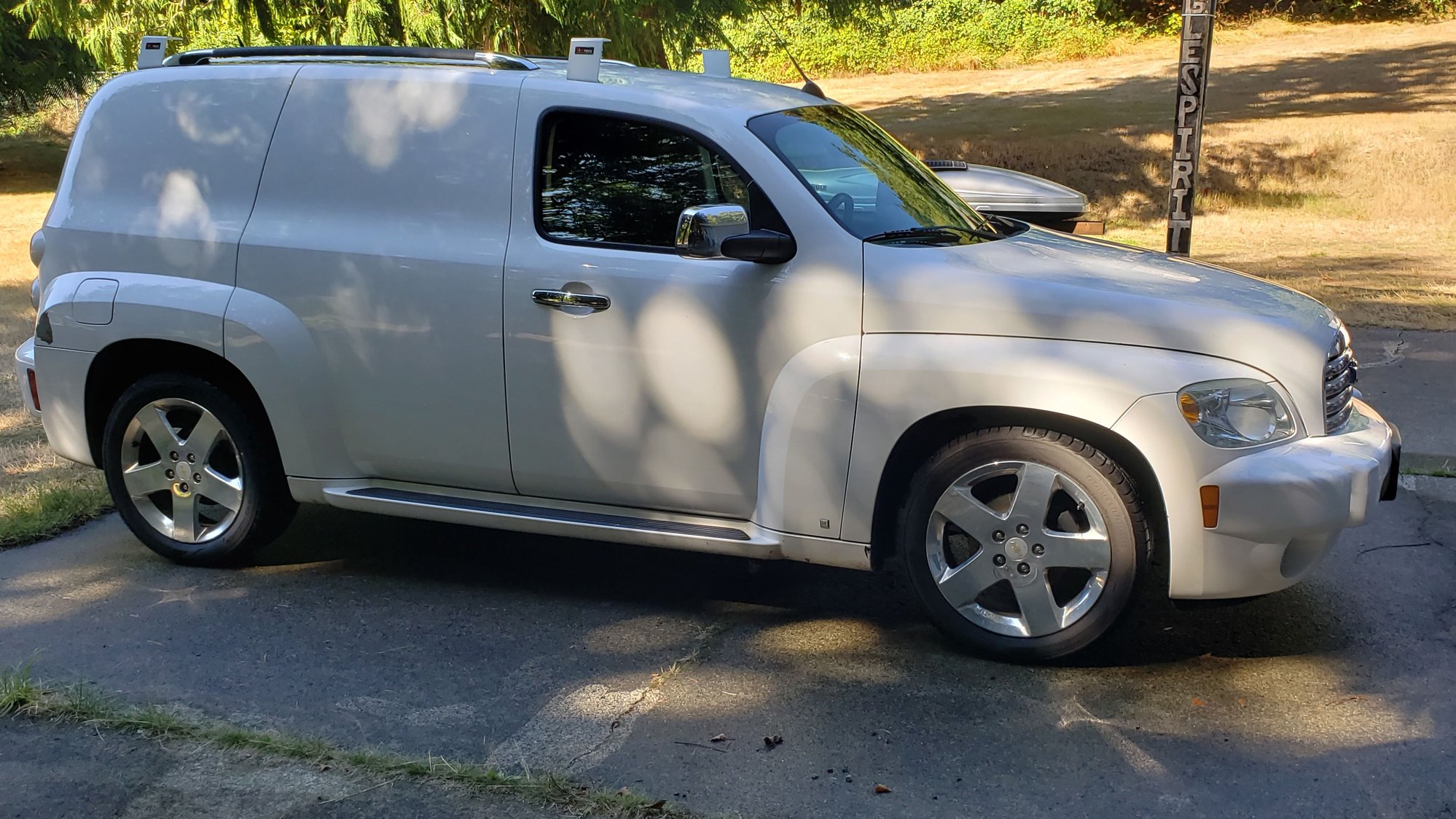

Old Oct 4, 2023 | 05:40 AM
