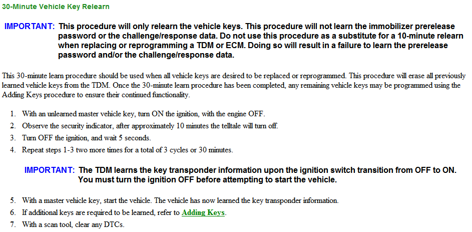

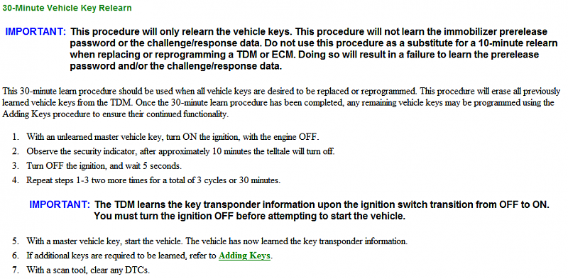

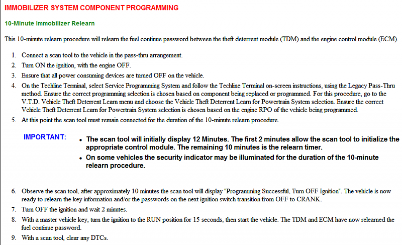

Why not go to a dealership and have the ignition recall done, if it hasn't already. Or, take your title or registration and your VIN to a GM parts department or locksmith and get a new key made, then you could also open the door?

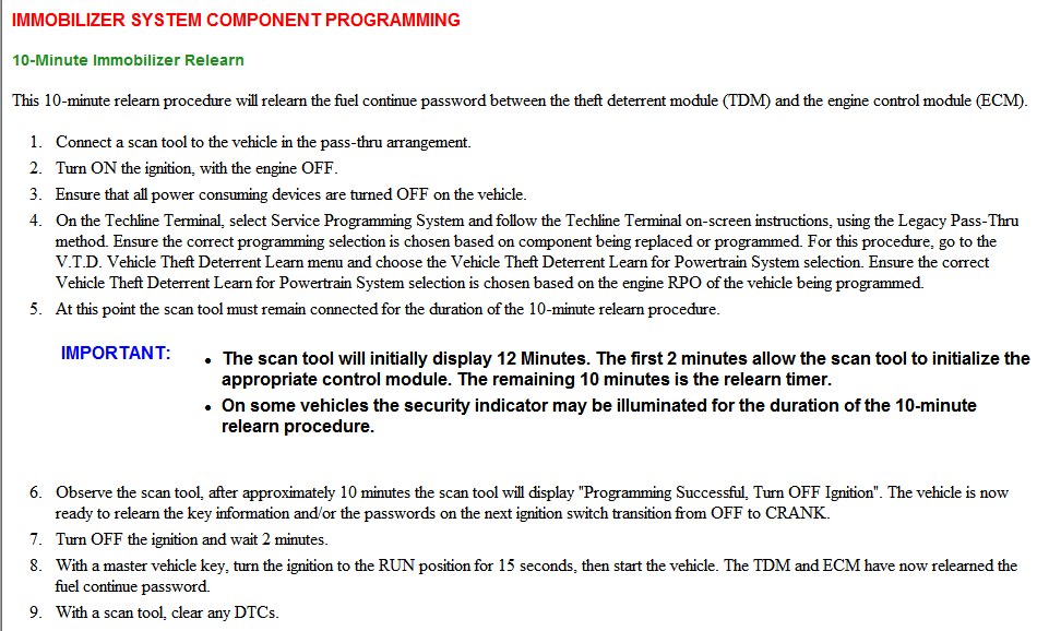

So, I was hoping this was something I would be able to do myself. From what you posted it would seem that I have learned the key to crank the vehicle, but the reason it will not continue running is that I need a GM scan tool to make it learn the fuel pump continue password.
That's a bummer.
I did get the ignition cylinder, door lock cylinder and key from the junk yard. Now I guess I need to see if there is anyone around that I can get to plug in a GM scan tool for the rest of the relearn.

Is there an outstanding recall on your car? If there is it's a FREE fix for you. And now you are driving an unsafe car assuming the junkyard part was not a recall solution part, since there is no way to tell. People died for the recall.
https://www.chevyhhr.net/forums/gm-r...-status-50716/
Mechanic or no, why not get a key cut to your VIN instead of re locking the entire car?
Most mechanic shops around here have Snap On computers, some of the mechanics even know how to use them beyond reading DTCs.

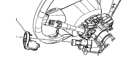

Your attempt at 30 minute solution evidently did not succeed and you managed to erase the codes in memory.
The security bit is the plastic part (#1 in the attached pic) that fits around the keyway. Did you keep that part or use the junkyard part that matched the junkyard key?
Your shop doesn't have Mitchell1 or AllData?

Thanks for the info, it looks like it has two outstanding Recalls, both related to the Ign switch and lock cylinder.
Yes I have Mitchel and a SnapOn MODIS.
Mitchell was where I found the info for the 30 min relearn.
Before the 30 min relearn the vehicle would not crank. After the relearn it would crank but not stay running. Wasn't sure if this was do to another procedure that needed to be performed.

My attachments are directly from Mitchell1.
The MODIS is capable of anything a Tech2 can do up to sourcing firmware from TISWEB, might even do that if you pay for the subscription.

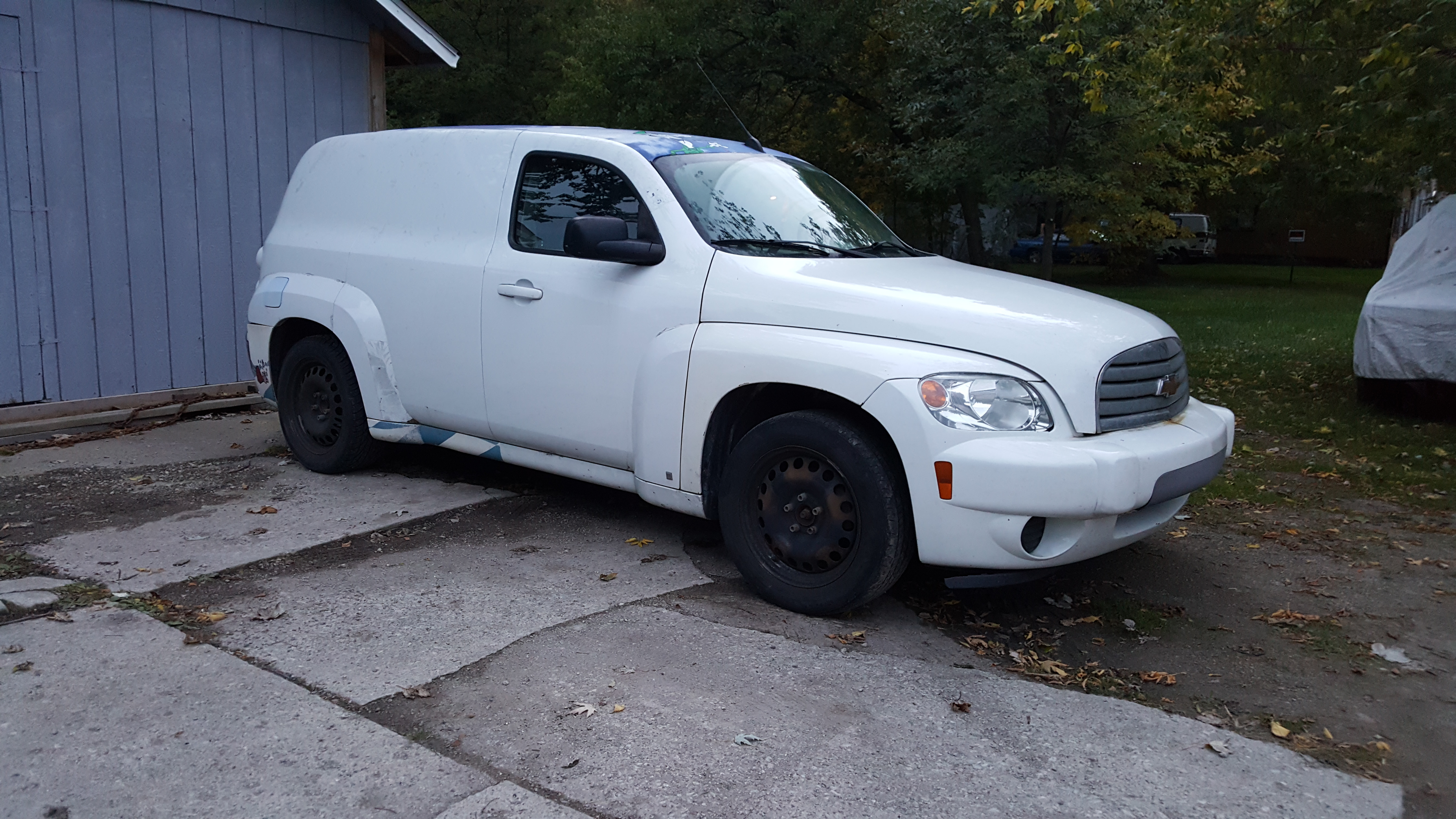

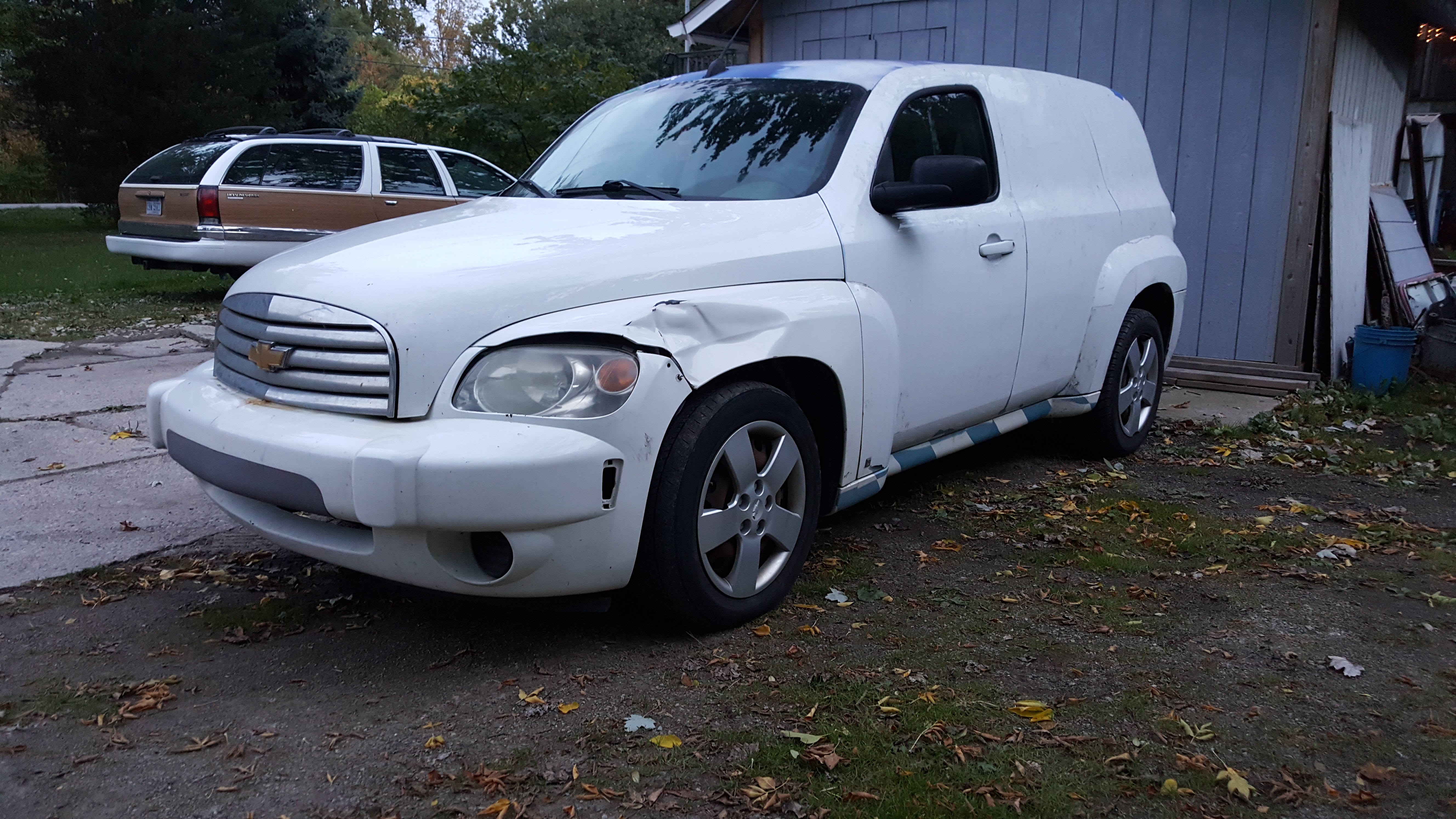

Drove it home from the dealer this evening.
Thanks for the heads up about the recall!
Smitty
