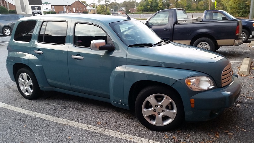

Hey folks!
I'm a first time HHR owner, but a second time owner in the model...I had a '07 Cobalt prior, and loved it. I needed a daily driver, and didn't want to spend >$5000, as I'm paying off a '15 Challenger R/T+ and a '15 Silverado LTZ Z71.
Well, I picked up the Mystery Machine (2007 LT, 2.2L) back in October w/77,500 Miles on it for $4,000. Had a little rattle up front, so here's what's been done to it since I've owned it:
K&N Filter..I looked on here, and figured the CAI would be a waste of money..my live sensor readout tells me that between ambient temp and intake temp, there's only ~4 degrees difference...I can't imagine a CAI would do much better
K&N Cabin Filter
NGK Plugs
Centric Calipers/Rotors/Pads
Moog Tie rods, inner/outer
Moog Sway Bar links
OEM Sway Bar Bushings
Gabriel Front Struts
Gabriel Rear Shocks
Moog Cam Bolts
Lower Control Arms
Generic ELM327 Bluetooth OBDII
Torque Pro for Android
Jensen VX7020 Head Unit (had to be inexpensive..and it rocks)
Boss BX45 Signal Processor
2x Boss 400w x 4 Power Amps
4x Kicker 6.5" 3-way (Doors)
2x Boss 4" 2-Way Speakers (Back Pillars)
12" + 250W MTX Sub/Amp Combo
DBLink 4F Capacitor
Every light in the car (except headlights) are LED's
I plasti-dipped the grille Anthracite Grey
Scooby-Doo Floor Mats
(Pauses to catch breath in fingers)
Still to go:
Another set of speakers...if I can find somewhere to put 'em.
Focal F05 Rims
Goodyear "Assurance Touring" Tires...I needed 80K treadwear
Trailer Hitch
Drivers side sun visor
With my trip into work tonight, I cleared 90,500 miles...so 13k down in 118 days.

And Welcome - nice looking 2007 you got there. And what a list of changes/mods/upgrades you've already done.
