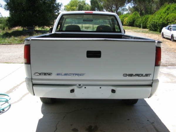

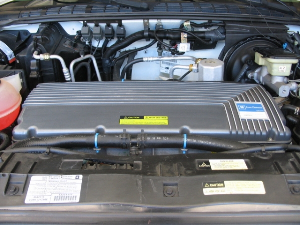

I had an Electric S10, and it used a "heat pump" same idea as the one that heats and cools our house. At very low temperatures it had a back-up diesel fired heater, but no one I knew who had these vehicles ever used it because most (of the 50 or so in private ownership) were in Oregon, California, and Florida.
The condensor and evaporator (back of the engine bay in the photo) reverse their roles so to speak depending on whether you are heating or cooling.

Just to clarify, my 1997 Chevy S10 WAS a TOTAL electric. Produced in very limited numbers in 1997 (Pb acid Batteries) and 1998 (NiMH batteries).
