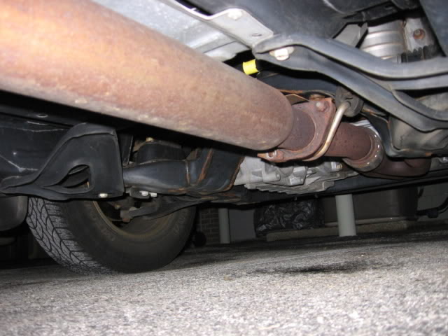

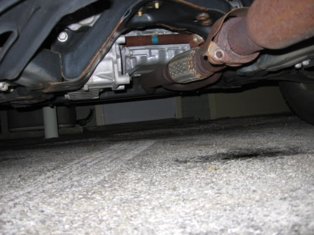

On Friday my wife's Vue started to sound like a Civic with a Fat Can exhaust on it....tonight was the first chance I've been able to look at it...
I don't know too much about exhaust but you can see that one of the bolts has rotted out on the part that holds these 2 pieces together probably right below the driver....moisture leaks from there and it feels like the end of the bolt is still on the other side...
Any idea of what I am probably looking at here?
Easy fix or am I gonna get gigged for a whole new exhaust? Any shop like Midas, Meinke Monore etc able to handle something like this?

A new gasket and two bolts. Cheap fix if you do it yourself.

Shouldn't Be More than $40.00 "TOPS"! Put Vehicle On Lift, Remove 1 1/2 Bolts, Clean Both Flange Surfaces, Install New Gasket and Relplace New Hardware! My Muffler Guy would be Between $20.00 and $30.00 Max! I would recommend a Custom Muffler Shop instead of a Franchise! Sometimes the Franchises will have you Leaving with a complete Cat Back Exhaust System!

Ok over on BITOG I got some good advice as was mentioned here....if I want to DIY I'd need a punch and hammer and half to know what size bolts etc to get...I'm just hoping the other bolt holds for a few days until I can get it in for someone to do it
I think it sounds cool but my wife just gave me that death stare when I mentioned it
I'm not bad to doing a lot of DIY stuff but given the condition of this hardware I'd rather let a shop do it..
I hammered on that bolt for a bit with a screwdriver and the end of a ratchet (I know but couldn't even find a damn hammer jeesh) and it didnt seem like it wanted to budge.......would a punch and hammer get it done?

A punch, a hammer, and enough force would get anything done.
Don't know how much you want to put into it, but if I was going to do that and not replace the exhaust, I would have a shop cut and bend some new pipe to fit, you could even use the stock cat and muffler using sleeves or flare the ends and clamp em.

A respectable auto repair shop could get you in and out for low dollar$. Don't go to an exhaust shop, as they are too keyed on selling parts. Use an independent shop recommended as honest by a friend.
