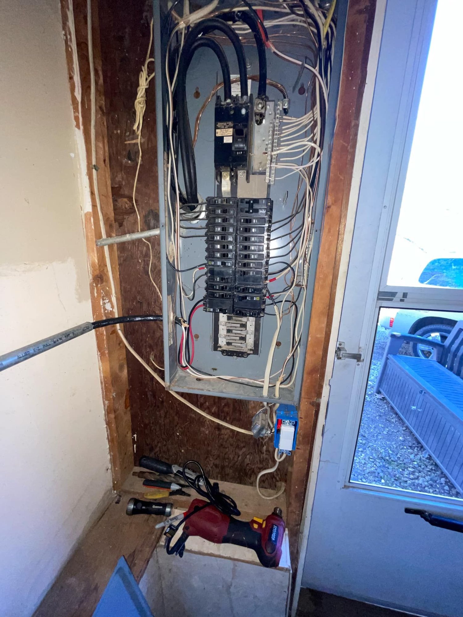

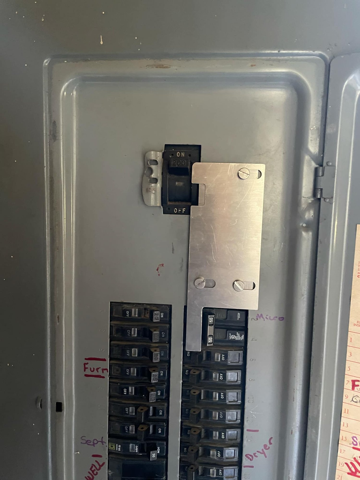

Today I just decided to get into the panel, The previous owner had a nightmare in there ( wires too long, wires doubled and wound up instead of cutting shorter.... just a mess ) so I cut back the sheathing and shortened some of the wires, rerouted others to clean the box up a bit.... I really want to just pull everything out and redo it to bundle the wires ( Hot, Neutral, Grounds so it looks more professional ) I may tackle that later. But today I got the breakers moved and installed the 50 amp for the generator. had to return the surge protector as its the wrong style... so new coming soon.

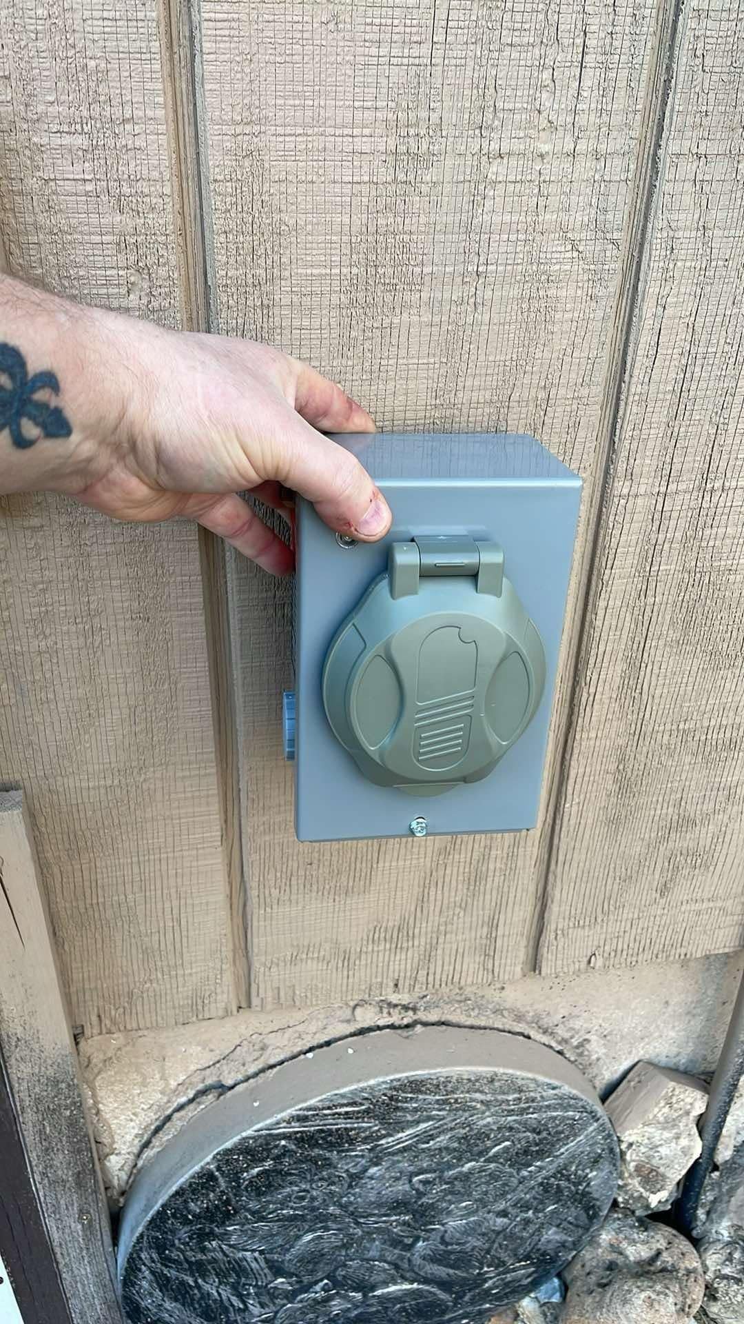

Tomorrow I will be mounting the exterior inlet box for the generator hook up, then I need to get the 6 gauge wire to tie it all in.
Installed the interlock kit and attached all the warning labels. I also marked the white wires that are carrying a hot load so it is all up to code as well.
Also coming in is new color coded location label for easy identification as well as what to turn on or off during the switchover. I will be removing the old label and already cleaned the marker off the panel. Also, running wire to the exterior box is simple, right out the wall below the panel so really short run.
