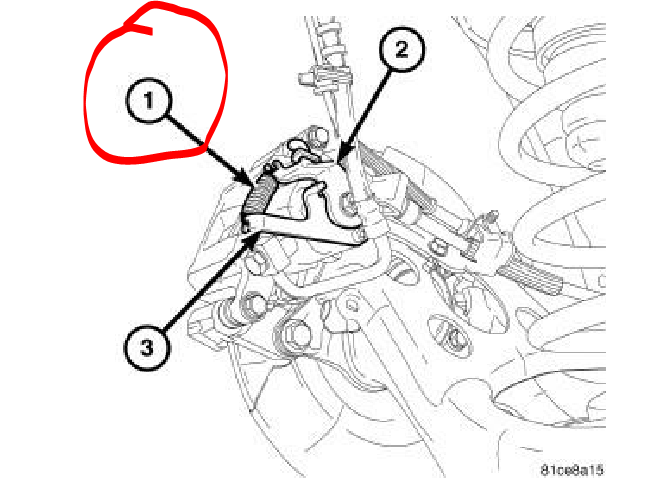

Posts: 26,523
I took a look at Mitchell. I think there is a caliper lever return spring in play, it is part of the parking brake. Maybe the slider pins are sticking.
