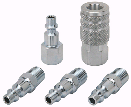

I just bought a very nice professional size Eaton Air Compressor (assembled in USA and most parts made here too). Couple of questions on tools. A 3/8 and 1/2 air wrench are obvious, also a cutoff saw and die grinder. What other air tools are useful that any of you might recommend based on your own experience? Also, there are at least 3 types of quick disconnect fittings, but I can't really get an answer on which is the best or preferred (just that they all work fine but are not interchangeable). Thanks for any input.

Use standard hose connector fittings similar to this (all same size)
