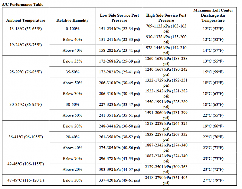

My AC went from working one day to not cooling the next. At first it seemed like the common Tstat problem but I have ruled that out. Here are the syptoms if anyone could help diagnos the problem. When you first crank the car sometimes the AC works good till you start driving it. Then cool air goes away. The AC clutch is engaging and compressor working when its blowing cold and when its blowing warm. Clutch is still engaged. With AC gauges on it and when its cooling the low side is at about 45-50 and the high side is at about 190. When the AC quits cooling the Low side will climb to 90 and high side is staying at around the 190 on the pressure gages.

You know more about A/C than I do. Here is the pressure chart:
