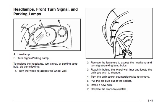

How do I get to the front turn signal bulb? It is located next to the headlight assembly. Is the white bolt on the fenderwell used to release the unit?
Old Nov 12, 2008 | 04:35 PM
From the owner's manual.......

Those fasteners are a pain. Other than that it's easy, might want to way right or left to get more clerance if your hands are inflexible or large.
Old Nov 17, 2008 | 10:47 AM
Lee3333's Avatar
Joined: 12-18-2005
Posts: 1,791
From: Middle Village, NY
It wasnt as bad as I feared, but I wish they would have used 3 screws instead of 2 of those stupid push pins. I realize that for assembly they are quicker, but what a pain in the a$$ to remove. And I am worried that they will break if removed too many times. Come on, GM, light bulbs do not last forever and should be easier to replace.
