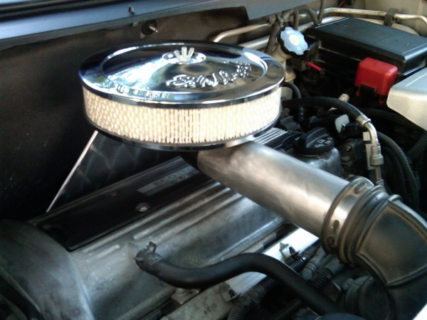

Originally Posted by lunchbox_mafioso
problem solved
How did you do that? Is it a kit or did you make the pipe and adaptor? What did you do about the wiring plug that goes into the the air intake pipe?
When I canged my air filter I unbolted the the two scres on the engine block and removed the whole mount. Easier then messing with that torx screw.

its not a kit, its custom made. just bent and cut some pipe ( 2 1/2" i think) welded the pipe to some sheet metal that was cut it out slightly smaller than the radius of the filter housing, cut the bottom of the housing out, and riveted the sheet metal to the filter housing. as for the mass air flow sensor, i ordered a weld on receptacle from gmpartsdirect, and bolted it on. the MAF receptacle is aluminum, and the pipe is steel, so i didn't want to try welding it up. i might get a better picture tomorrow. i did my first filter change last weekend with the new setup, and yeah, it only took about a minute.

here's a side view showing the MAF sensor, and profile of the pipe.

maf
part # for that maf rec ?

Part: 19166574*
Category: Computer Control Sensors
Description: BRACKET
Min.Qty: 1
Unit Price: $5.20
Quantity: 1
Ext.Price: $5.20
Core Charge: $0.00
SUB TOTAL: $5.20
SHIPPING: $12.95
TAX: $0.00
TOTAL WITH TAXES: $ 18.15 * indicates special order item, which is a special order non-returnable part.
yeah, the shipping is over twice the price of the part... but thats gmpartsdirect for ya.
problem solved
Nice job on that, I really like it.
Gives it a nice old school, retro look under the hood...
