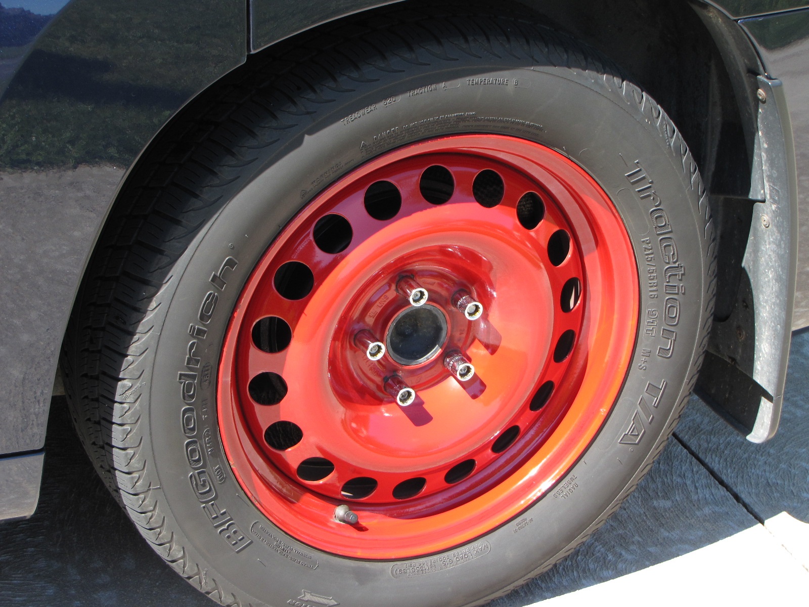

My stock hub caps are in the shed stacked up! The rims simply painted red!

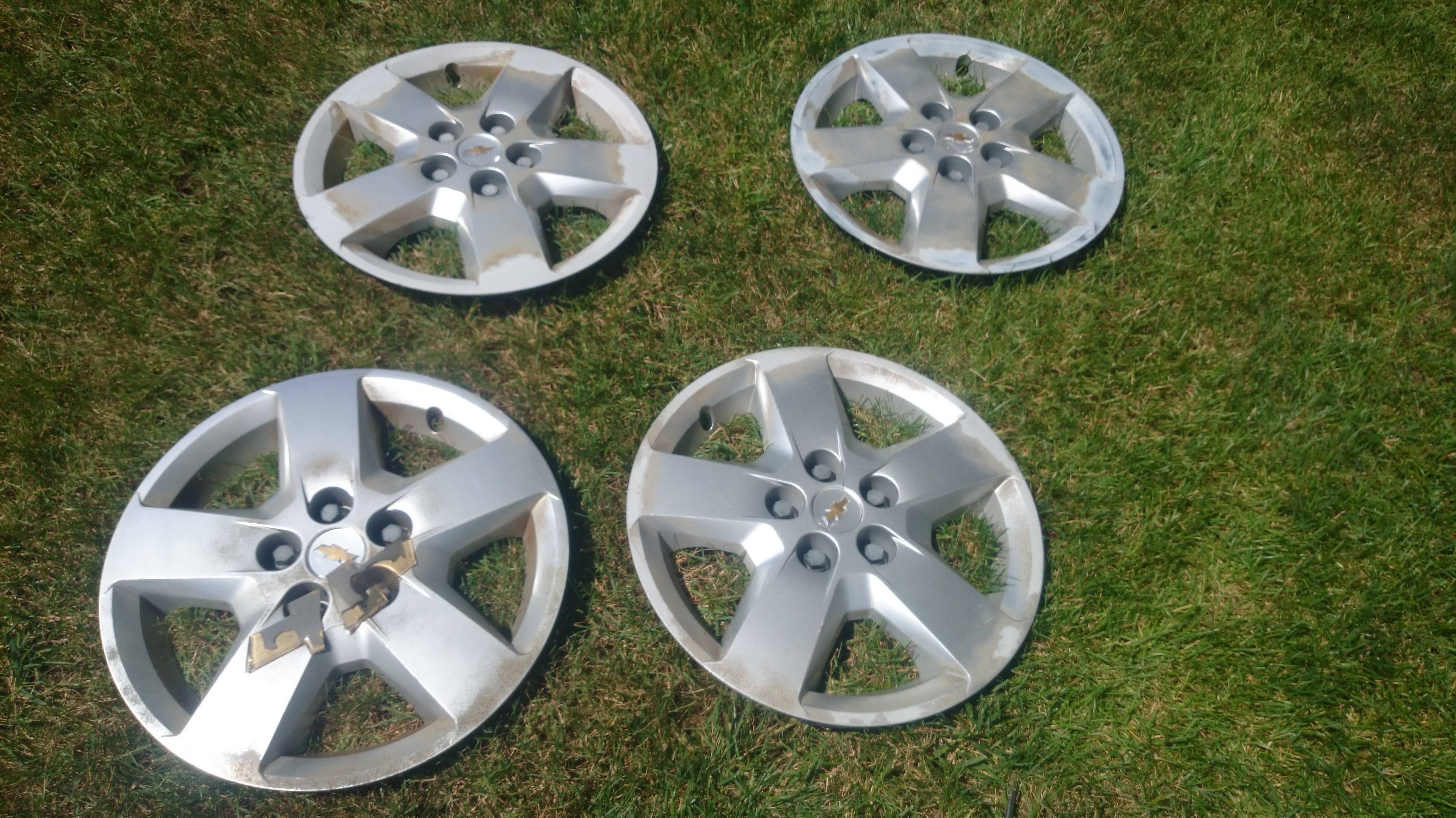

The wheel covers are bolted onto the wheel lugs, just unscrew the plastic nuts that you can see. Don't try to pry them off!

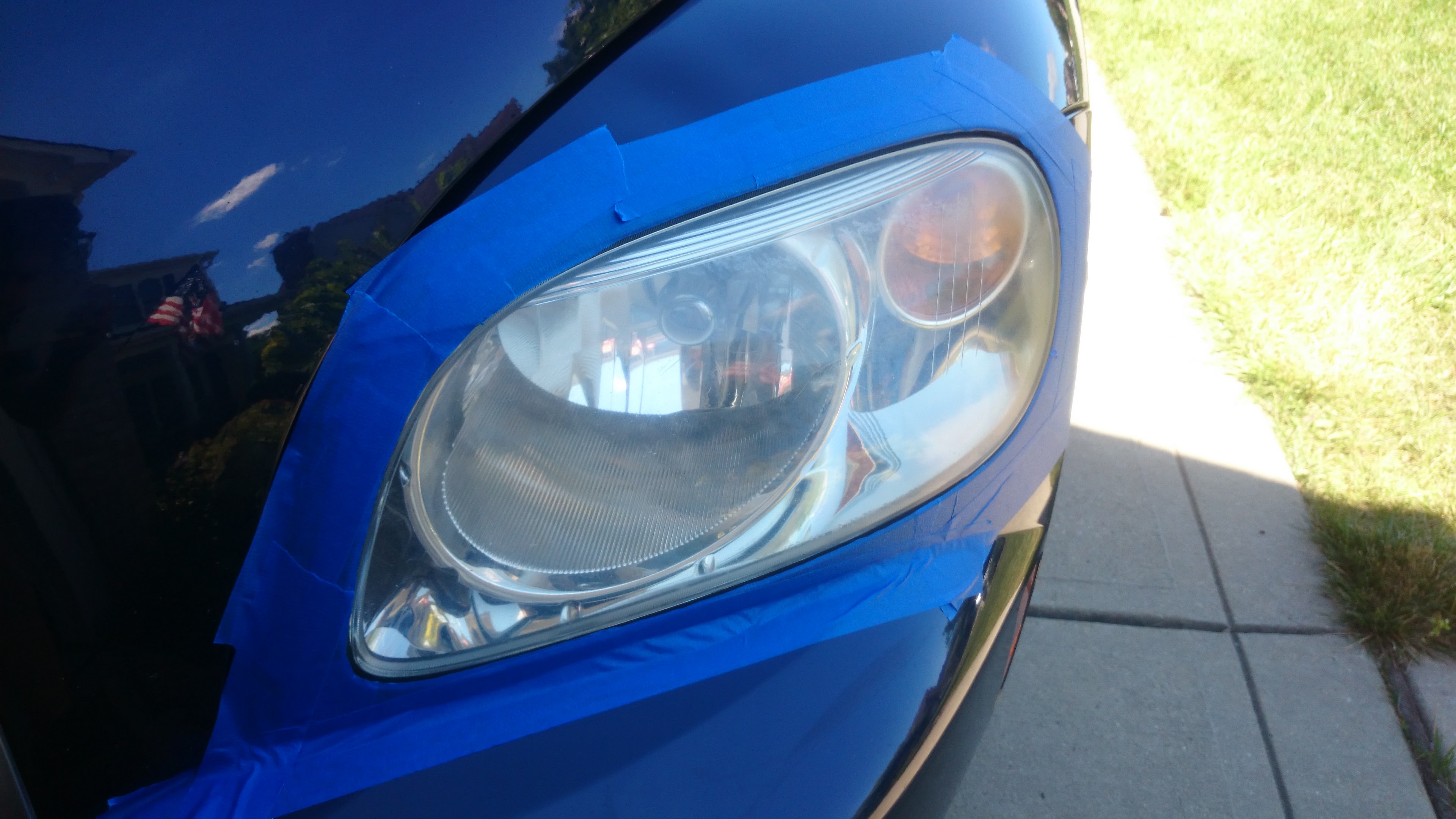

If theres one thing I cant stand is fogged out headlights. Any of the 3m type restoration kits work great and fairly easy. Just make sure to tape off painted edges, cuz you will acidentally buff up against them and it will take the paint off if you hit it for too long.
I also have a kits that doesn't require buffing, just wiping, but not sure it work as good.
If you don't trust yourself, a body shop will do it for peanuts. To me, it makes a huge difference, especially if your paintwork is good.

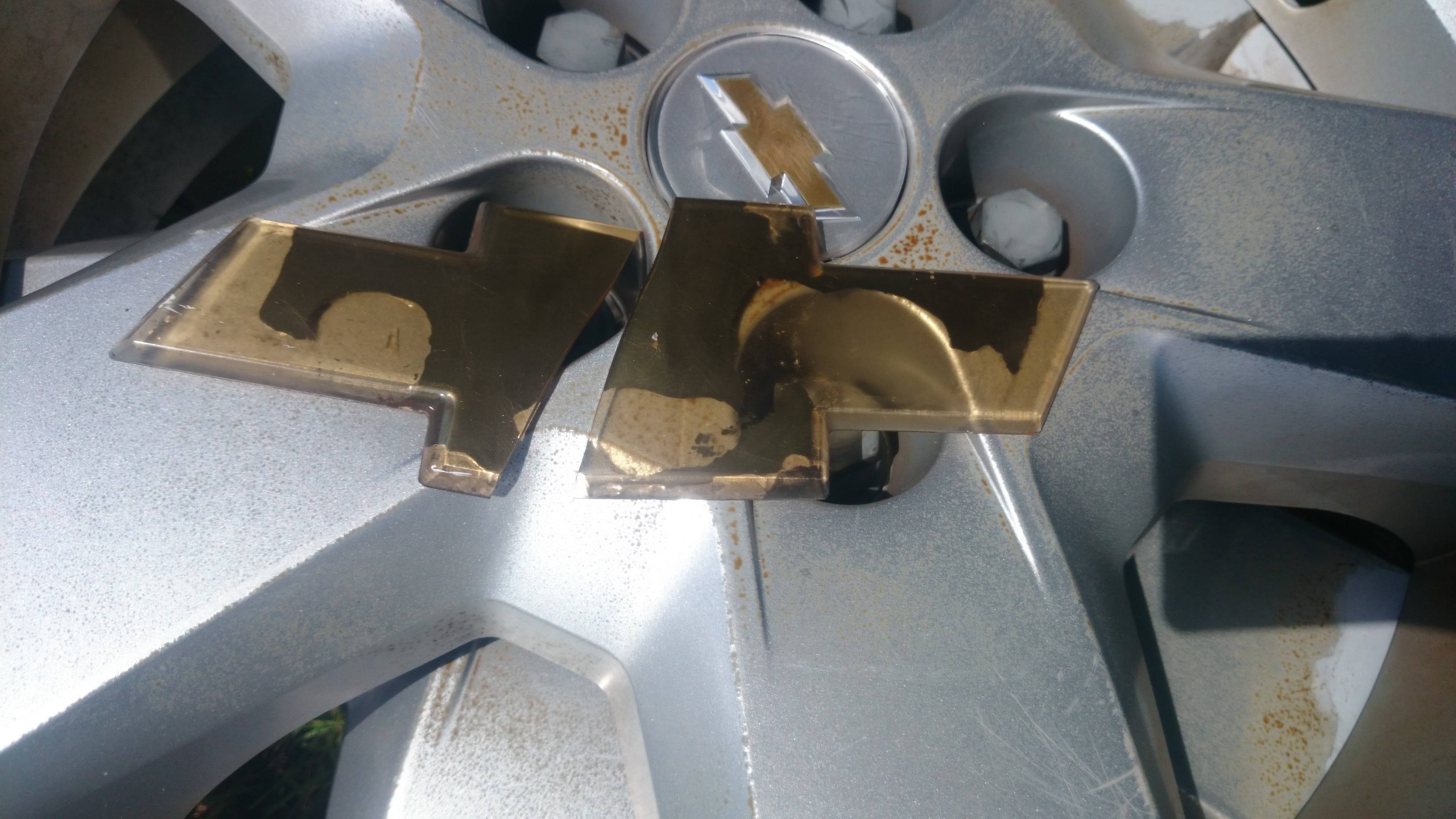

most pressing issue is does anybody know the part # for the rear chevy emblem off-hand? Mine sort of broke in half when I took it off. I might just CAD it up and have my friend print a replica, but I'd prefer to just order the part.

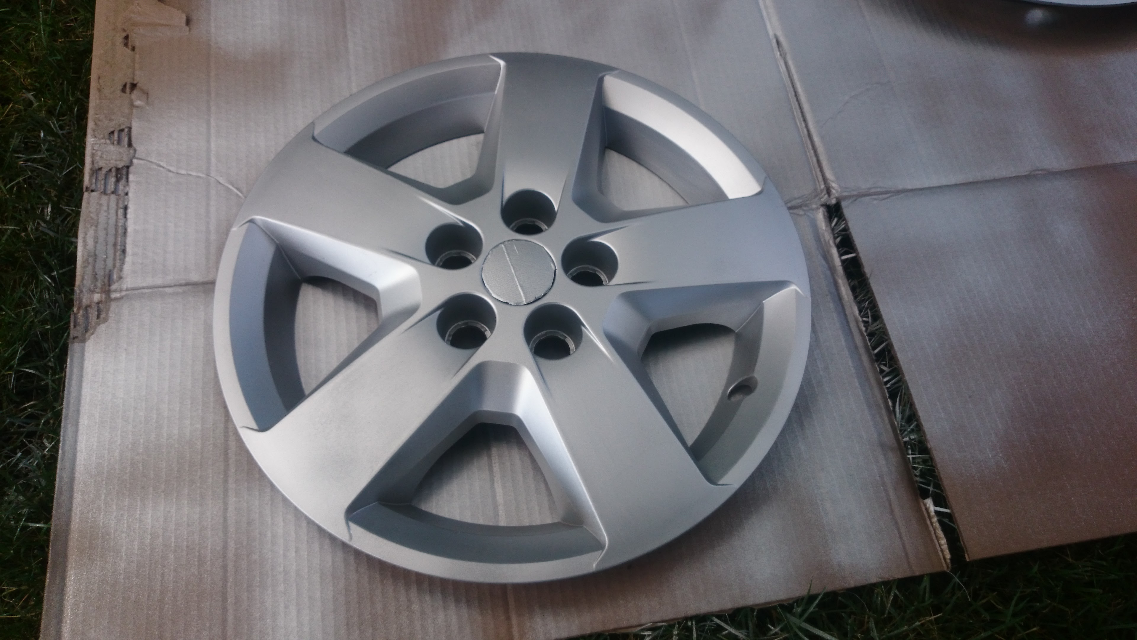

on to touching up the hub caps,

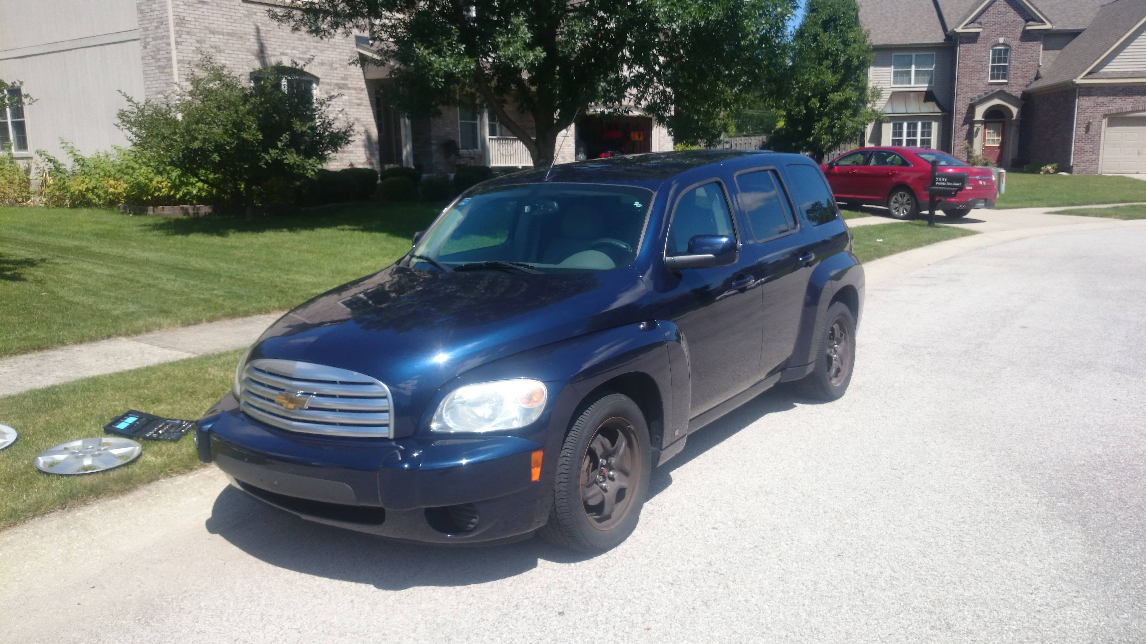

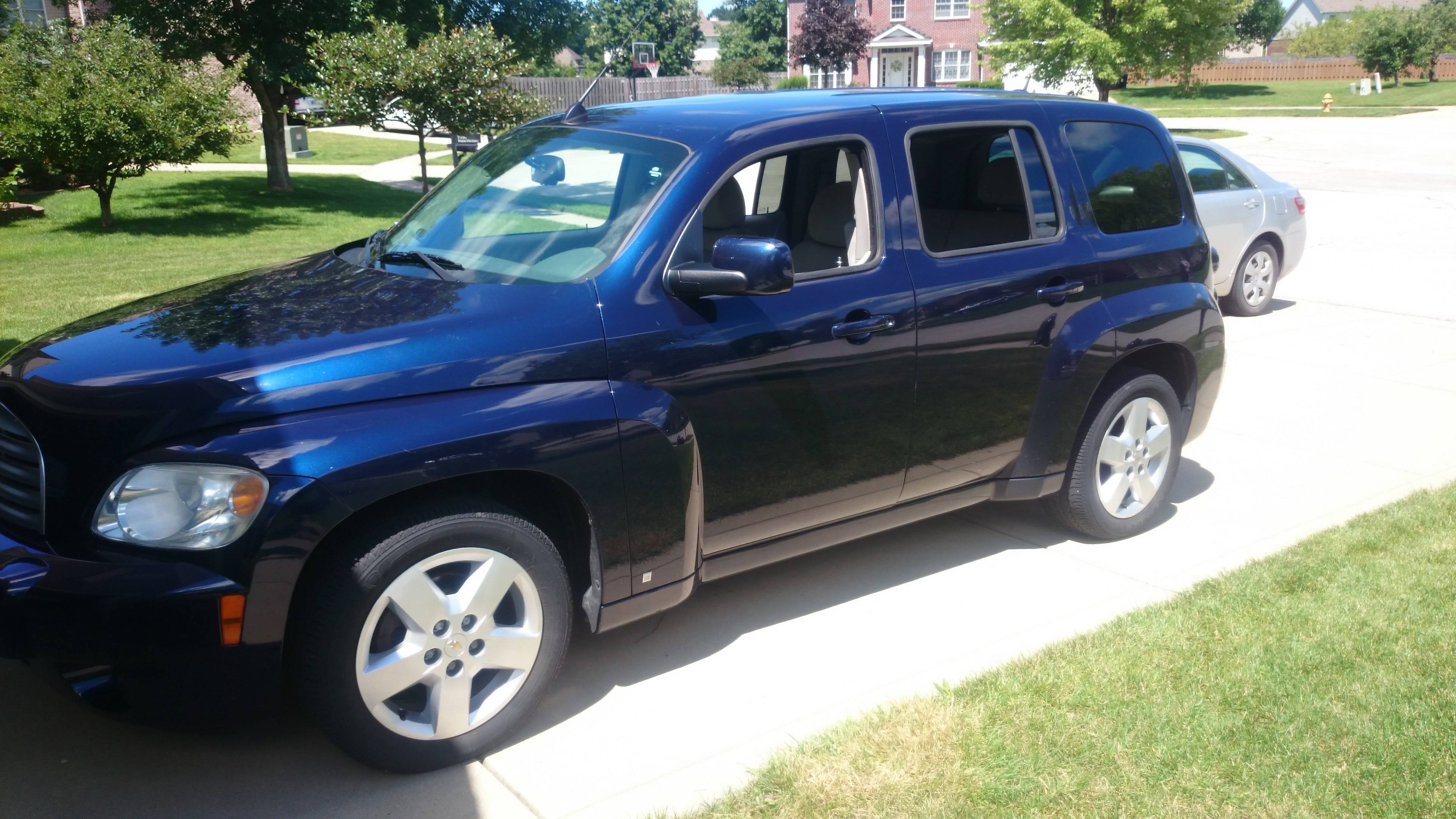

here's how the car looks without them on.

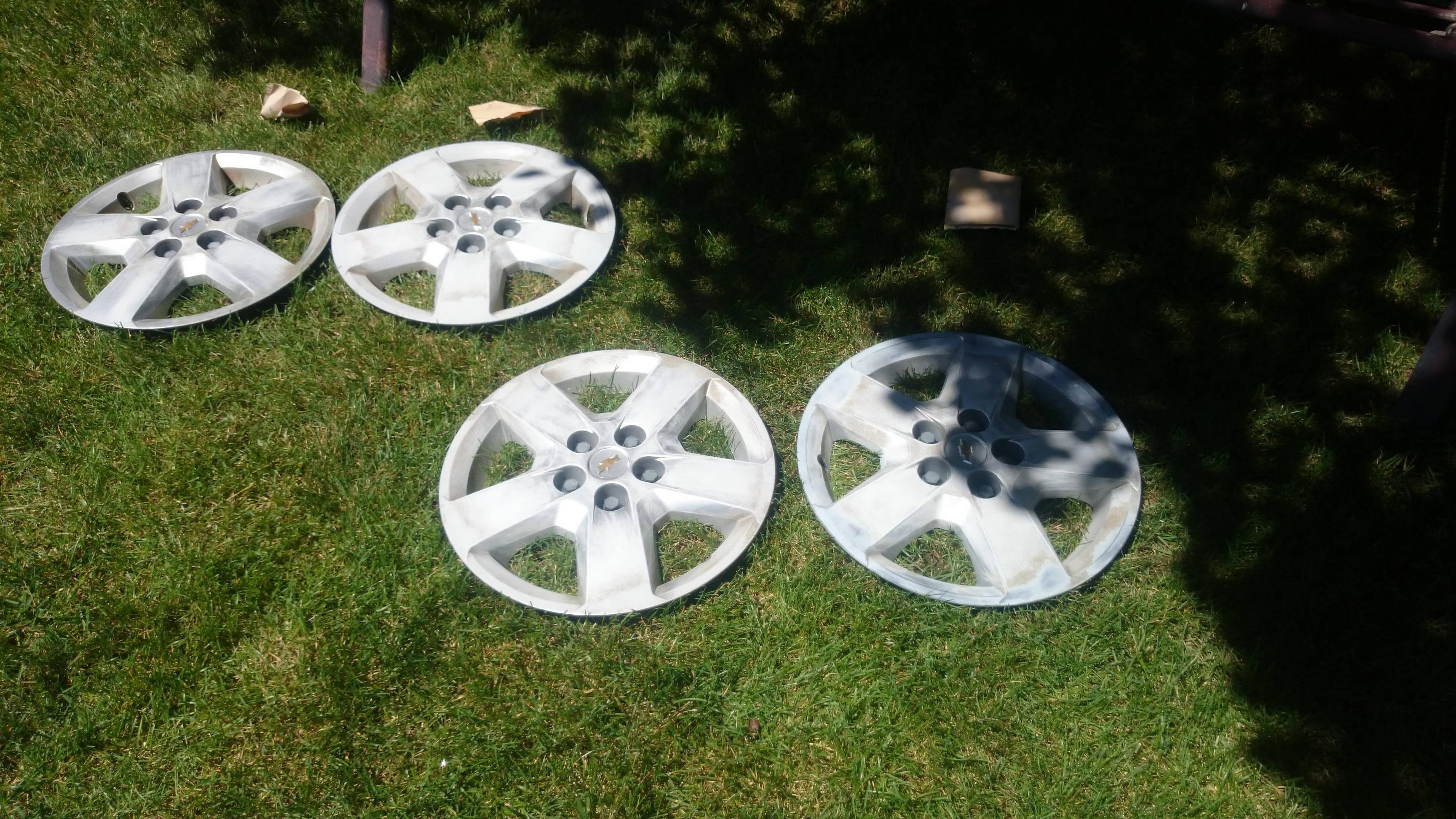

pulled the hub caps off
sanded, 150 grit then 220

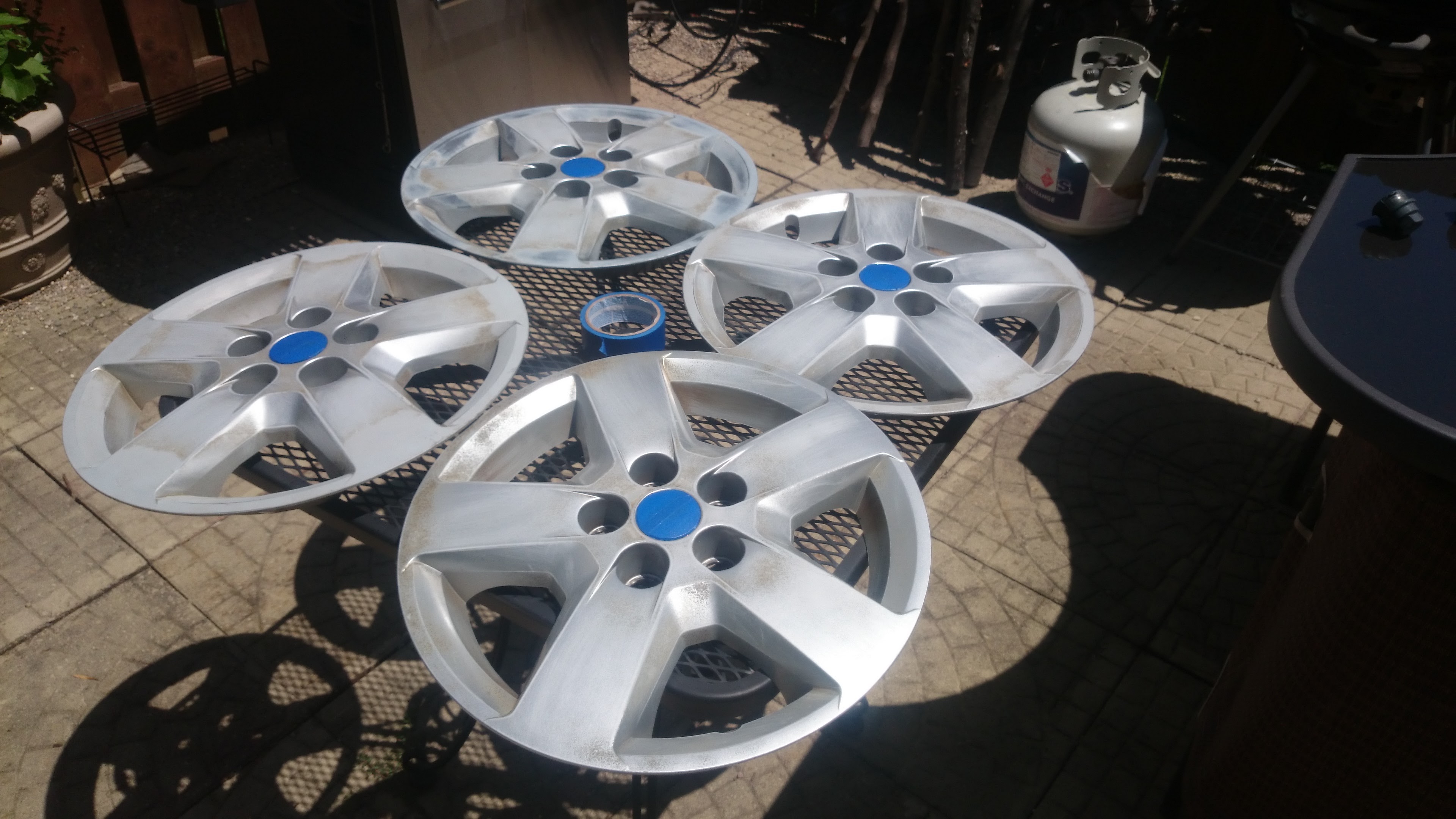

washed and masked

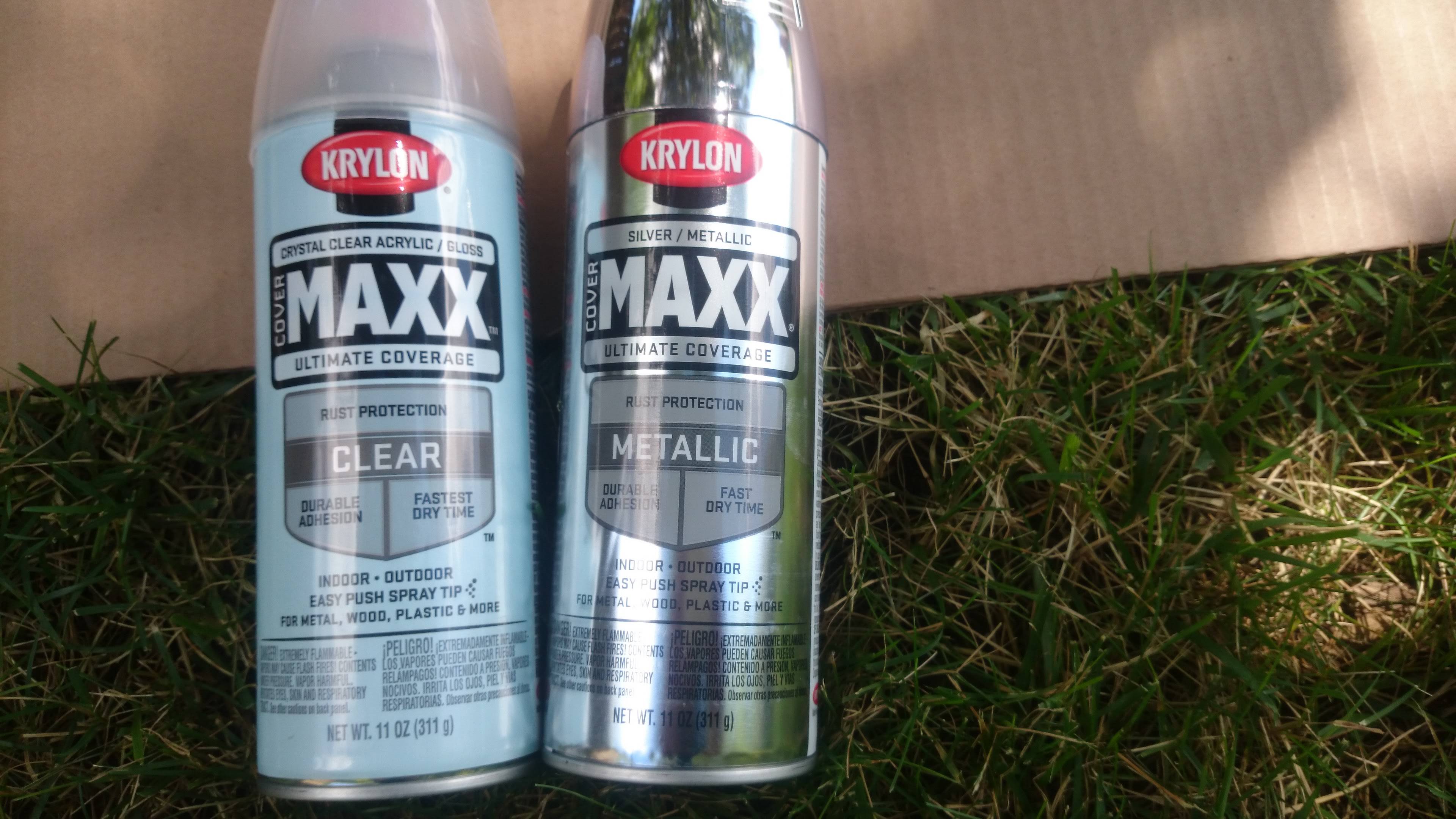

paint I used

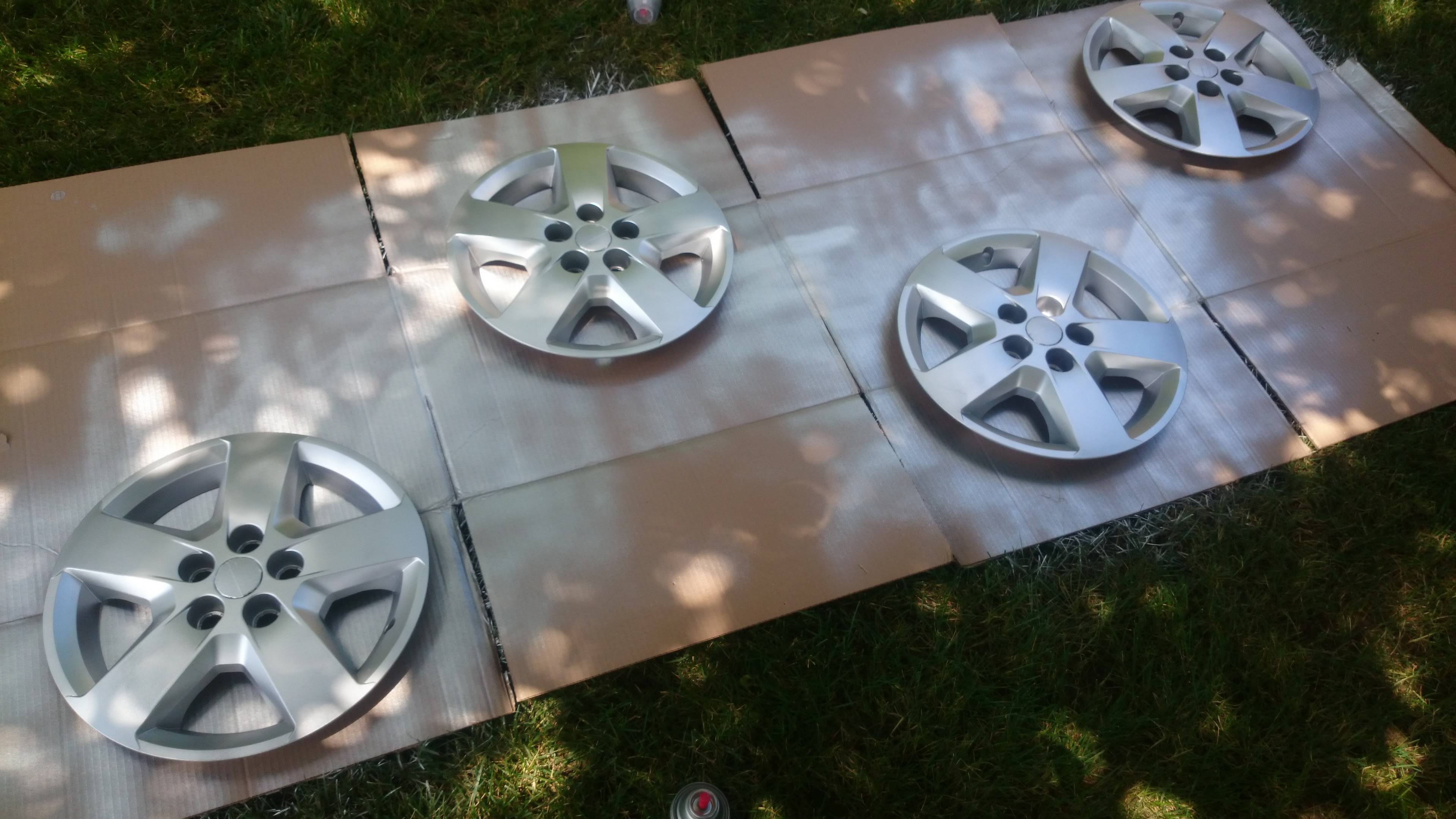

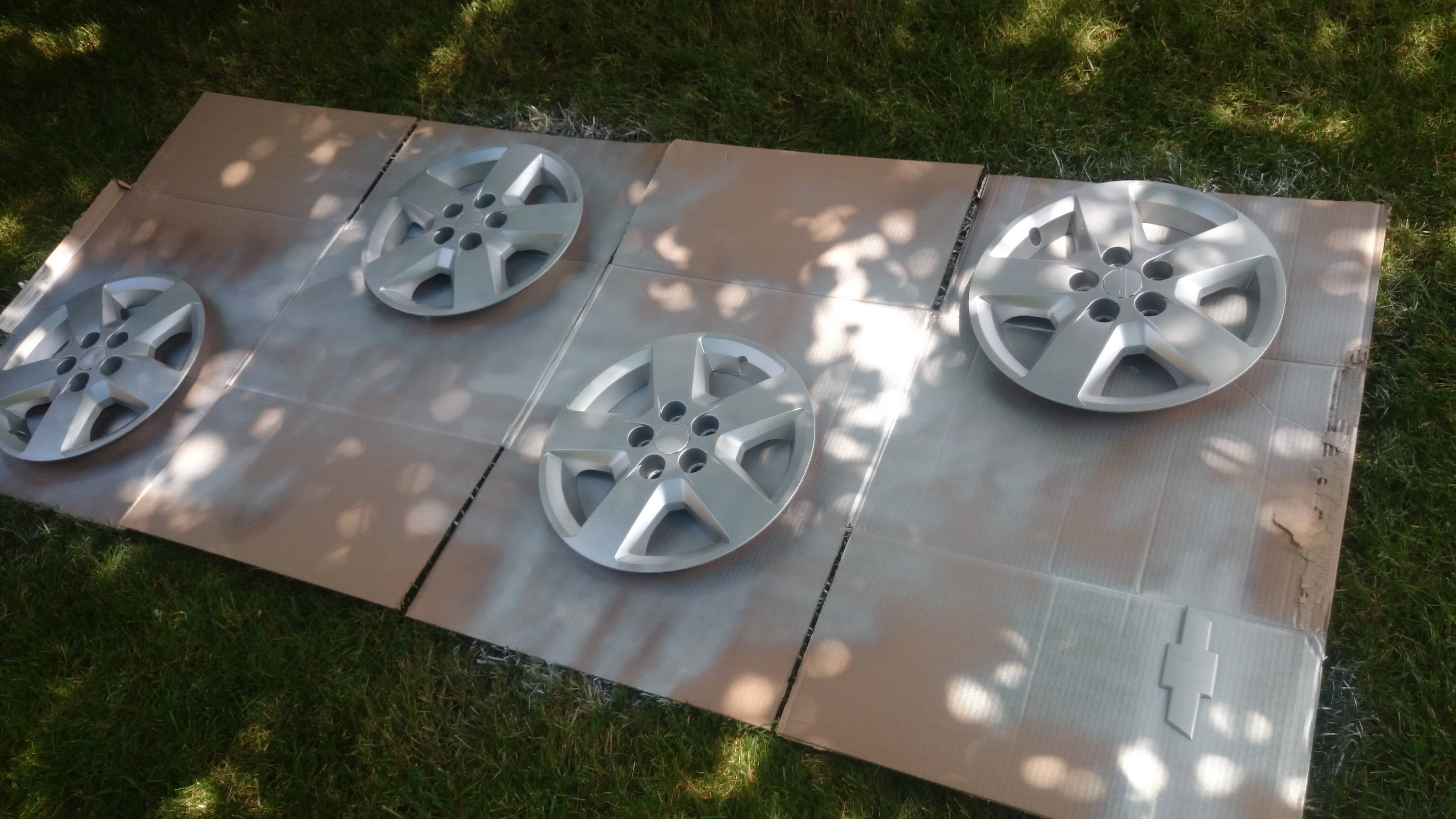

silver
clear coat
close-up on the wheel. not the best paint job, but it at least looks better now.

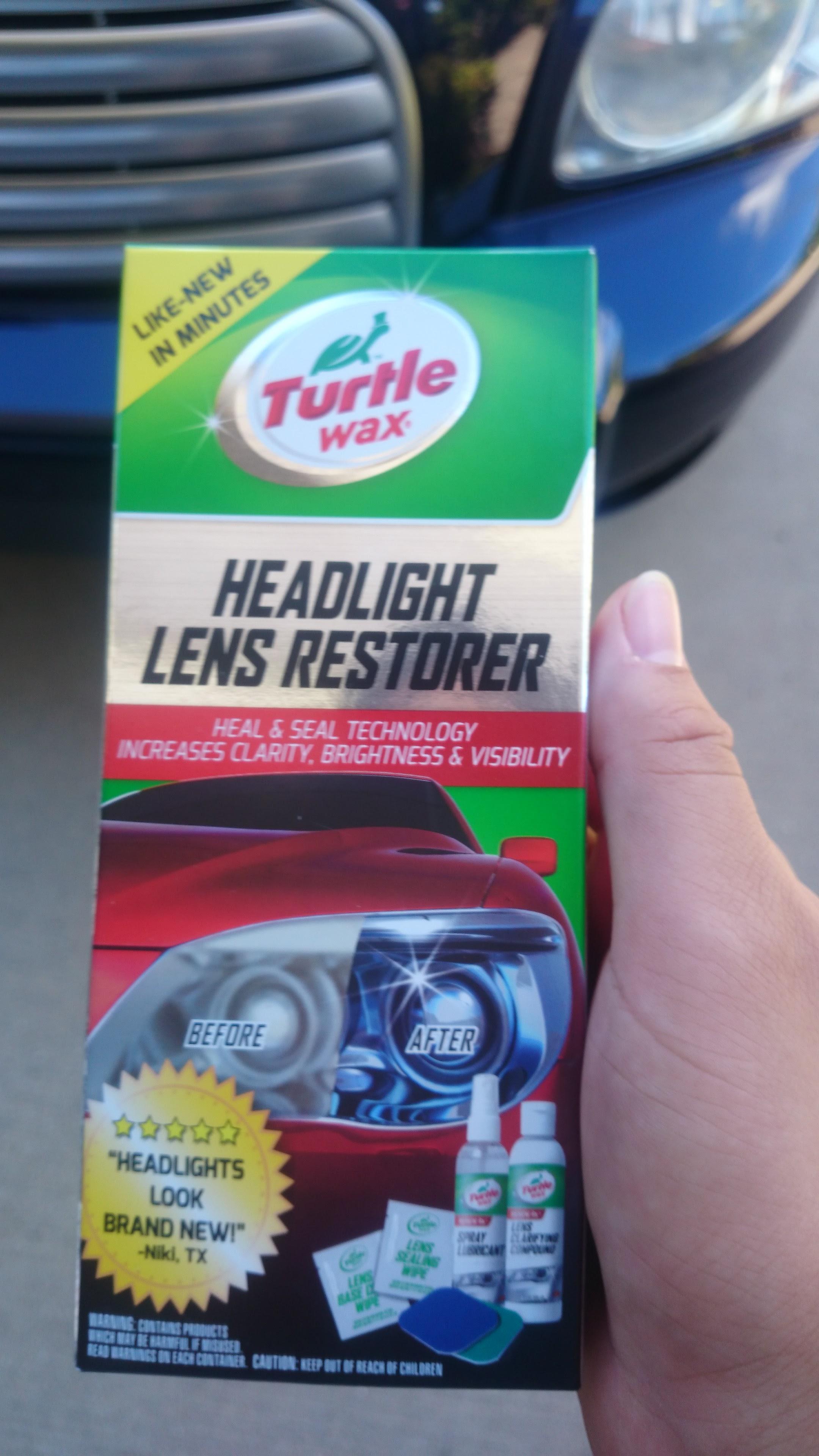

I used this kit on the headlight

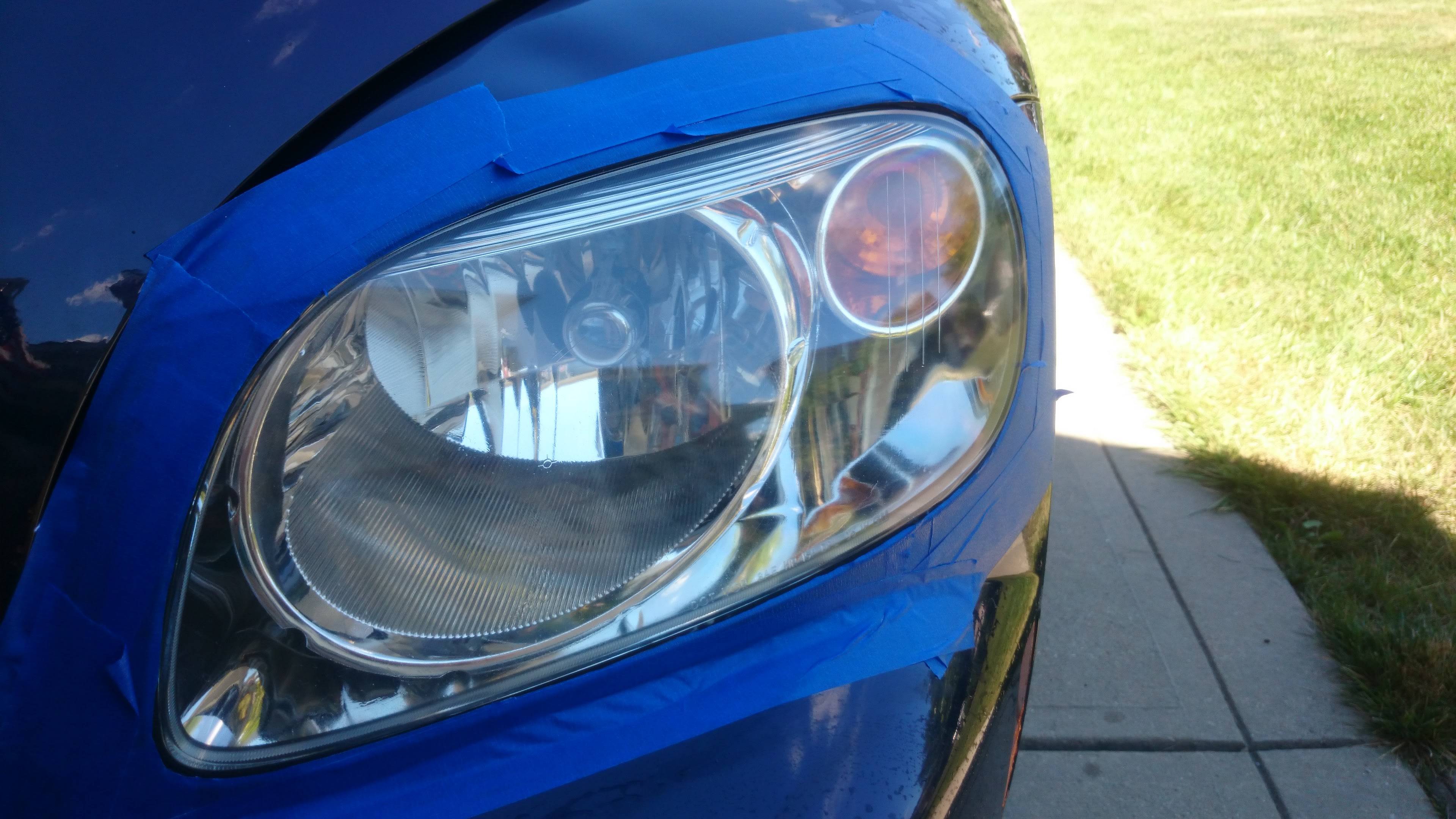

before
and after. worked a treat!

But yeah, if anybody knows where I can get a new rear chevy logo, please do let me know.
edit: does this look right? http://www.ebay.com/itm/NEW-06-11-CH...-/302010908322

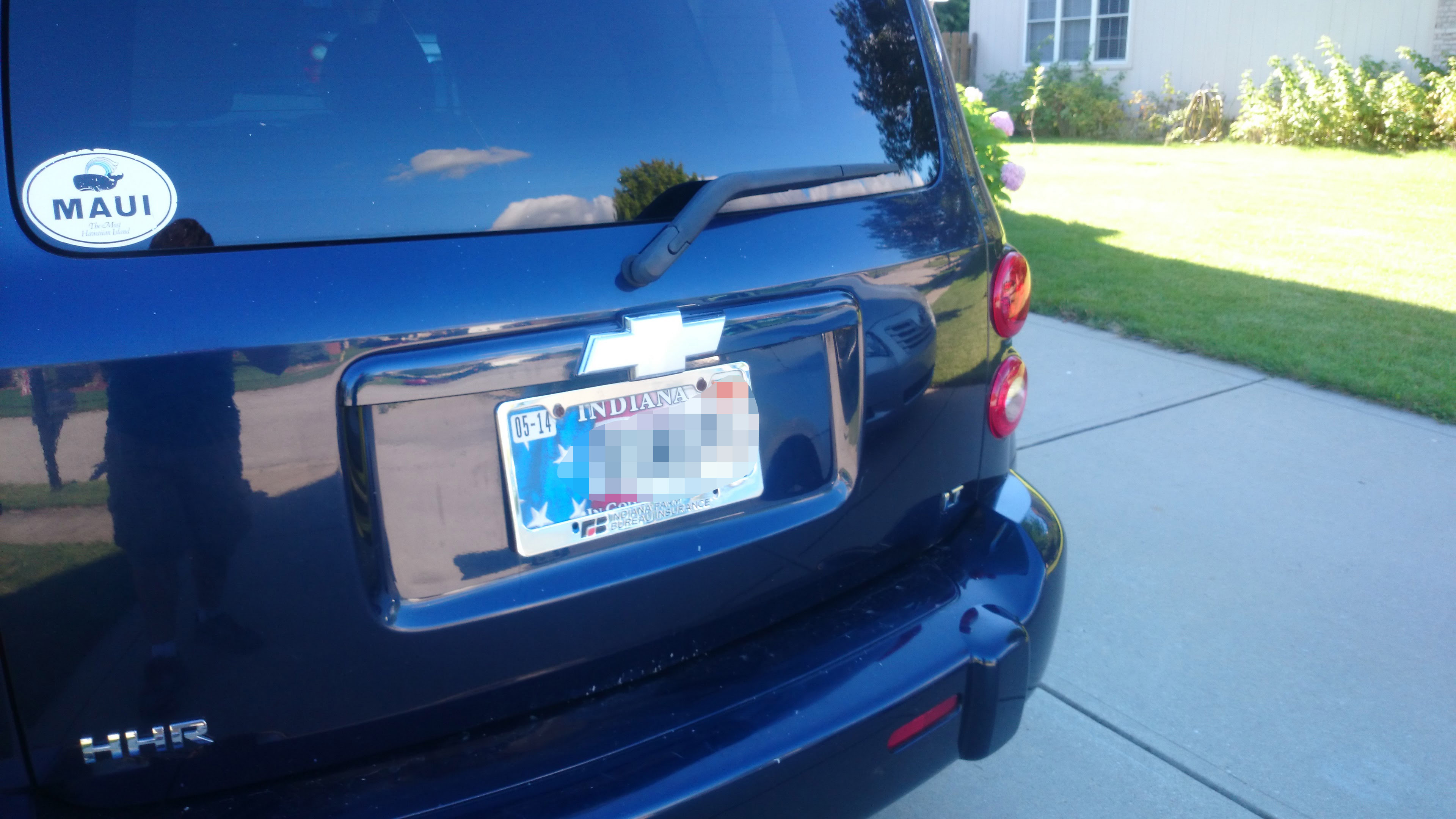

here's how the emblem looks right now. I didn't want to leave an awkward gap on my hatch.

The easiest and quickest way to find part numbers is to go to any online GM parts store and look there, like gmpartsoutlet.net.
Then if you don't like their price go to eBay and plop the part number into the search bar.
Yes, that says it is right. "any Chevy tailgate bowtie"
Old Jul 17, 2016 | 10:07 AM
Posts: 40,096
Yep, that is the bow tie, great job on the headlights and hub caps!
