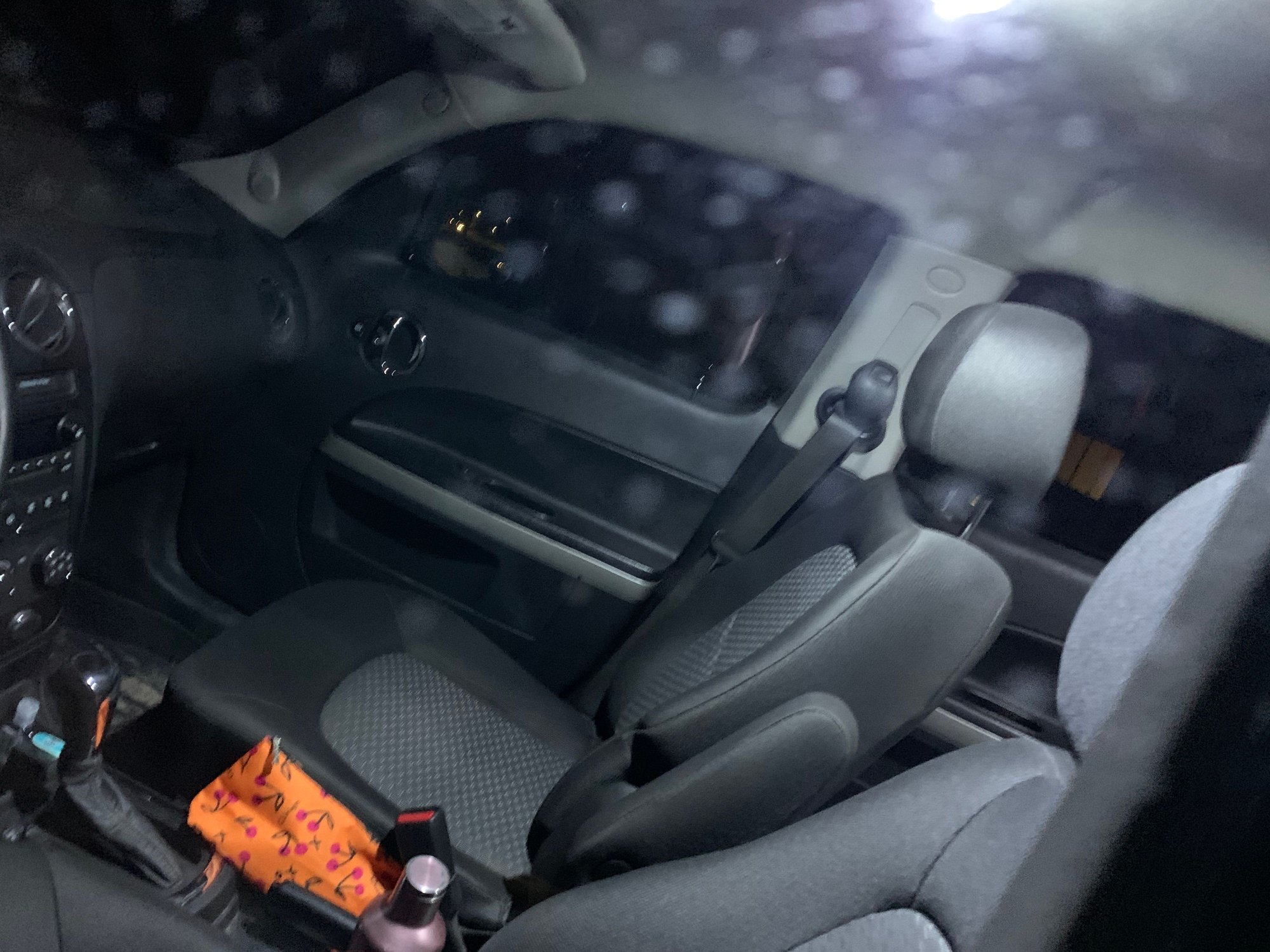

No here is a night shot
This is thru the driver’s window, dome lights on.

WOW mine shut off lust like the regular bulbs did ! Yours must be getting some feedback !
I am curious can you reverse the wires ?
so any difference ?
I know mine would not light id I had polarity wrong !
Old Mar 4, 2021 | 03:47 PM
Posts: 40,091
No, I tried reversing the bulb, then they just don’t light up. I just got replacement festoons from Amazon, 3 minutes to change all seven in my 2011, they all light up very bright and the centre bulbs dim and turn completely off after you close the doors. Fixed! But they aren’t as bright as the square ones, I might rig those either in the foot wells in a manual switch or as under hood lights.
