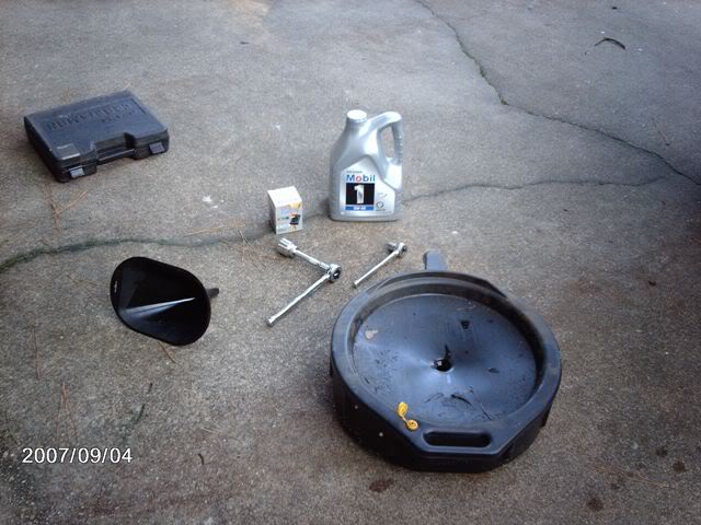

Parts needed
A method of lifting the vehicle (ramps or stands)
5 quarts 5w-30 oil (your choice)
1 Filter (your choice)
15mm socket for the drain plug
32mm socket for the filter cap (yes there is an SAE socket for the cap, but I preferred the metric), extension is very helpful.
Drain pan
Rags

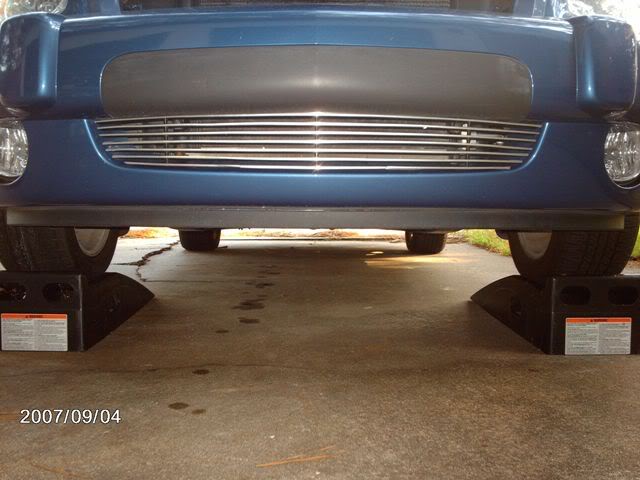

First of all, get the vehicle up in the air.
(The drips on the ground are from the A/C)

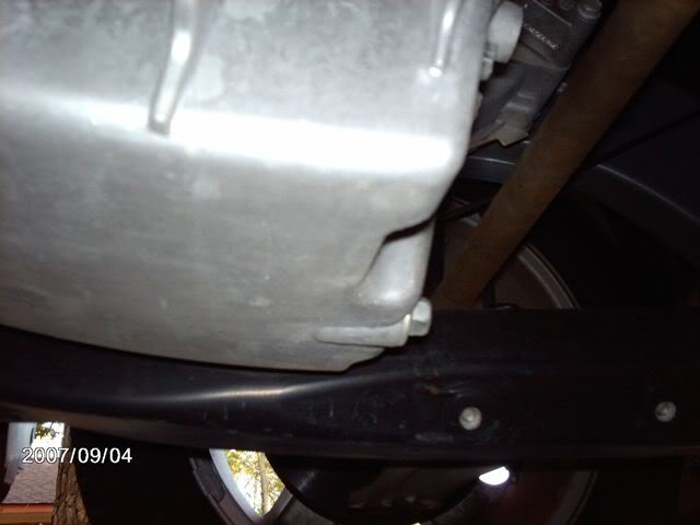

Locate drain plug under vehicle. It is on the passenger side. It take a 15mm socket. Place drain pan under before taking the bolt out.
Once the oil is drained, put the plug back in. If you are using the old plug, I recommend wiping it down good. If you are using a new plug, be sure it has the correct gasket/washer. Then move the drain pan forward some. The position of the filter is great, you probably don’t need the drain pan there, but better safe than sorry.

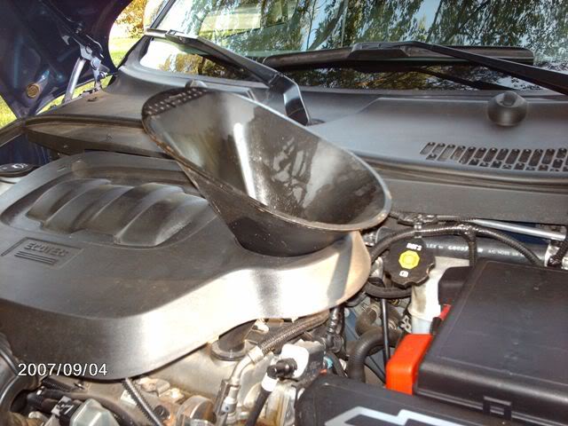

Take off the filler cap and put in 5 quarts of oil. You may want to only put in 4.5 quarts at first just in case you didn’t get a full drain. Then you can top off.
