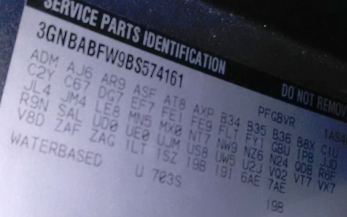

I bought a used 2011 HHR LT this year from a private owner when I bought it there where no keyfobs. I read on a post here saying that the HHR's came with keyless entry systems is this correct? If so can I just buy a fob and program it?

Look in the glovebox for the RPO codes to your HHR.
AP3 is the code for the keyless remote/start (the fobs and it's program). If your's has the AP3 then getting the fobs and programming them to the car should work.
If it doesn't have that code you're probably out of luck.

Will have to wait till tomorrow to check it, wife has the car at work.

I am not positive about the AP3 applying to 2011 cars.
Somebody said that 2010-2011 the code applies only to remote start, since all were supposed to have keyless entry. That is what I heard, I don't think my 2011 had AP3 but it did have remote entry/no remote start, but I don't have car anymore to check

Hmm guess more research is needed on my part
I found this from another poster on this site. I dont have auto start but dont mean i dont have keyless entry
