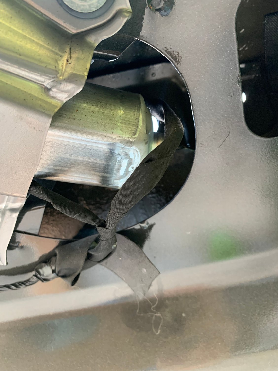

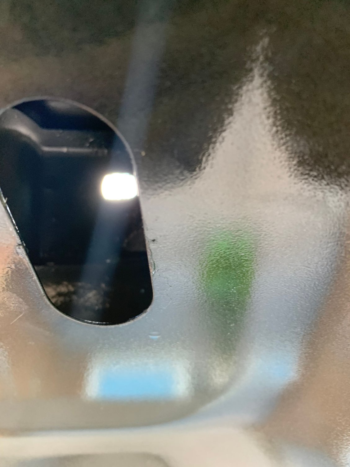

Old Aug 2, 2022 | 06:20 PM
Posts: 40,083
The driver’s side bulb
The access port to a fastener
The other side
You can access the passenger side from inside the hatch
The wiper motor blocks the driver’s side bulb
