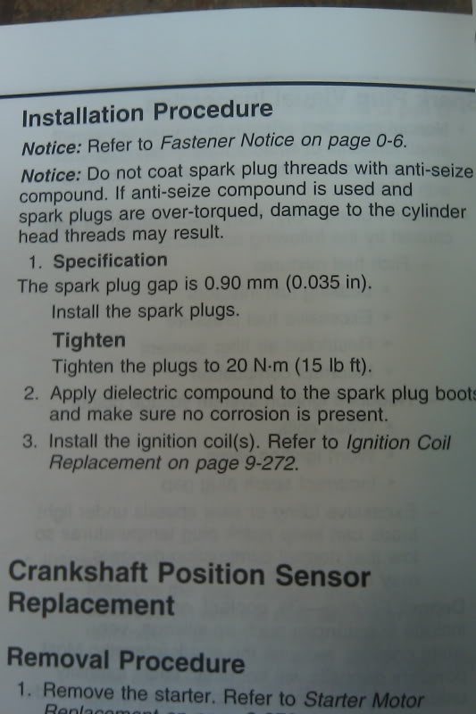

1Panel2NV Apr 15, 2011 05:53 PM
1 Attachment(s)
Originally Posted by Gas Man (Post 551235)
Why not use anti-seize?
I forgot about this until I looked up the torque specs...
Attachment 29315
Aluminum cylinder head. 15lb ft is not very much at all.
Gas Man Apr 16, 2011 10:36 AM
Interesting... however, I disagree. The reason you use anti-seeze is to keep the 2 metals from bonding causing a siezed thread. But oh well. Is that from a service manual? If so which one?
