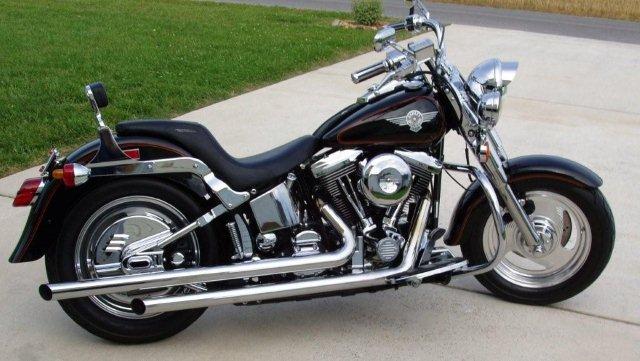

Old Feb 12, 2015 | 10:38 PM
I have used Rustoleum paint after cleaning the alloys' pitting on my 94 FatBoy.. That was back around 2000, still no problems..

Bill- These are the lightweight alloys on my 94 FatBoy I painted the rim bead, back around 2000 on.
I have since replaced 2 front tires & 3 back tires & the rustoleum is still holding up fine.
da bunny rabbit
