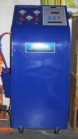

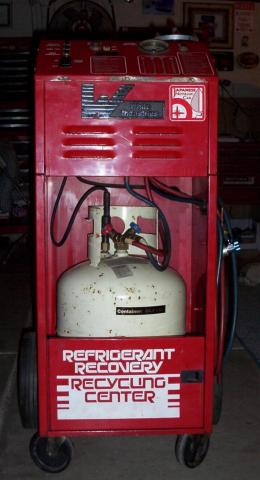

I actually have two recovery machines. A Central Machinery Recovery/Recharge that I use exclusively for R134a, and an old White Industries 1060 that I use for R12, R12 alternatives and home HVAC. The old one is easy to change containers in and clean out to avoid contamination from mixing refrigerants. I haven't released refrigerants into the atmosphere since I received my HVAC/MVAC licenses back in the 90s. They're fairly easy to get as Grizzly alluded to but fairly difficult to have reinstated. And there's the fine that goes with it also if you get caught (up to $25K)......
