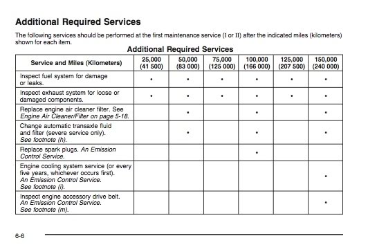

As per owners manual (these books do serve a purpose, you know):
Auto trans service is 50K (for severe usage)
Cooling system flush is 150K
Brake inspection & cleaning is not a bad idea, if it was never done.

I would recomend that you eyeball your owner's manual for the service intervals for:
* Transmission - Manual Page 6-6 indicates 50,000 miles - severe duty only
* coolant system - Manual Page 6-6 indicates every 5 years or 150,000 miles
whichever comes first
Following GM's service intervals (from the manual) are sufficient!

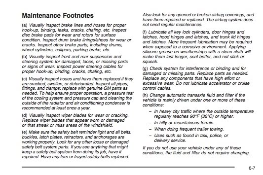

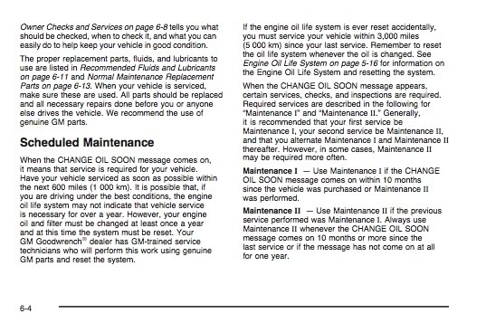

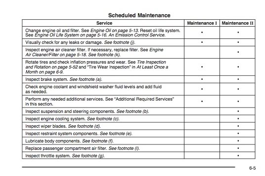

Old Mar 26, 2008 | 04:31 PM
Originally Posted by ng8650
My HHR just hit 30,000...does anything special need to be done?
According to the manual page 6-4 thru 6-6......
There is a 25K servicing that should be done on your next oil change after 25K.
