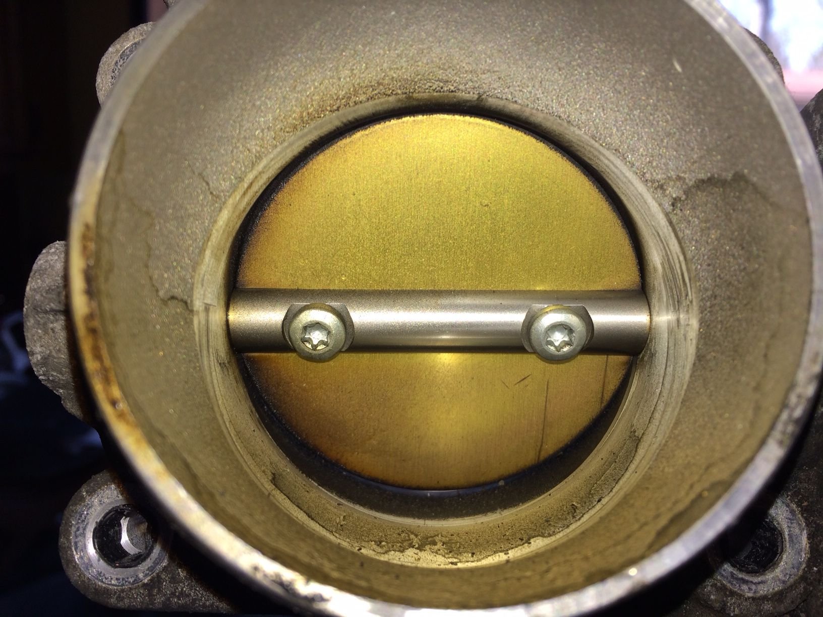

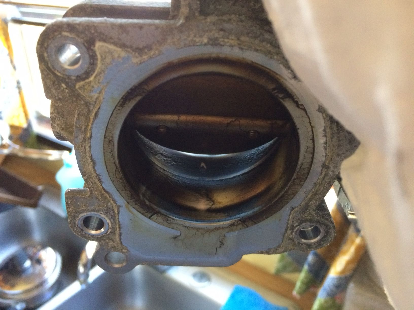

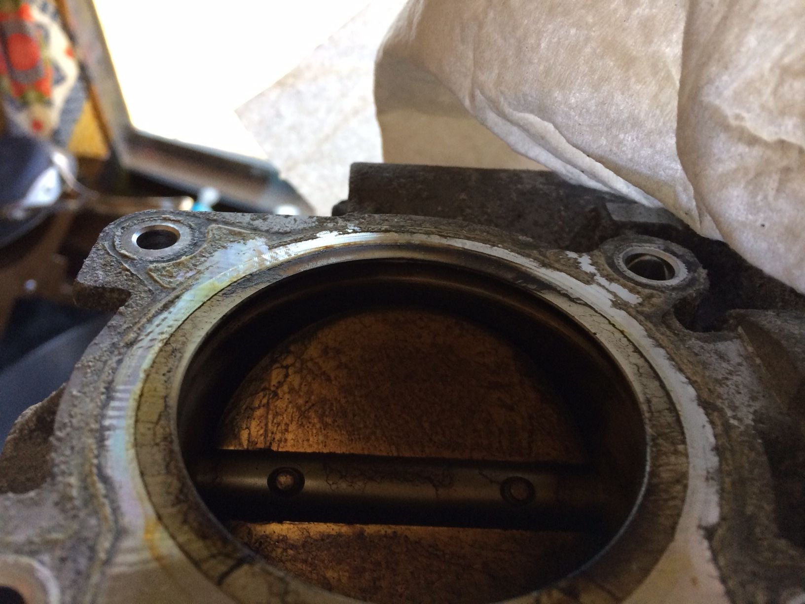

Just finished removing and cleaning the throttle body. First thing was to hold the throttle plate open with a wooden dowl. Just kidding. I was very careful to not move it. I used some brushes from the dollar store, Q-Tips, and a shop towel along with Silverfoxe's method of using a small pan to accumulate liquid (CRC TB Cleaner). Some pictures of before cleaning. Note the little bits of grit at the edge of the throttle plate. I forgot to take a couple after I was finished, but suffice it to say it was spakling and the grit was gone.

What happened to the rubber gasket? Looks like whatever was there was leaking. There is not supposed to be anything applied to it, just an O-ring gasket. Maybe a bit of grease.

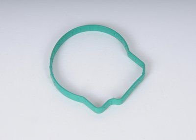

The gasket seemed OK and stayed put on the engine side so I left it alone. I didn't put anything on it. Idle was smooth afterwards. I assume you mean this gasket:

  #29
Posts: 26,483
Looks like somebody put some goop on it and there is evidence of leakage, to me.

Are you talking about a leak in the area on the body between the two bolt holes at the bottom of the second and third pics? I didn't see any goop or grease on the gasket. I've had the car since new and the throttle body's never been off. I did order a new gasket; when it comes in a few days, I can replace the old one.
