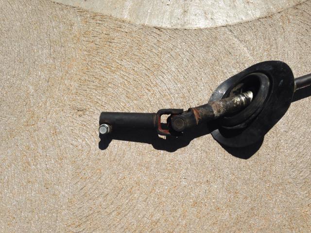

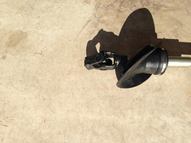

Size:  40.8 KBI ordered a replacement shaft HHR Steering Column-Intermediate Shaft 25834100 2 weeks ago, yesterday I went thru the pain of having my buddy follow my directions to swap out the original, turns out the yoke at the steering rack double D end is approximately 2 to 2 1/2 inches short and the other splined end just barely touches the end of the splined stub of the power steering motor.
Anybody have any input here to resolve this issue is there something I'm missing? I can't get down and dirty here just have to go by my buddy's explaination

Notice the length of the yoke in the new part in post one and this picture of original part
I did test the telescopic action but it wasn't the problem.

Yeah. The bottom end on mine looks like your second picture.
Sorry, I got nothing else I can add.

I have contacted the E-Bay vendor they are refunding the cost and have sent a return label.
I had to source another part at my GM dealer here,
