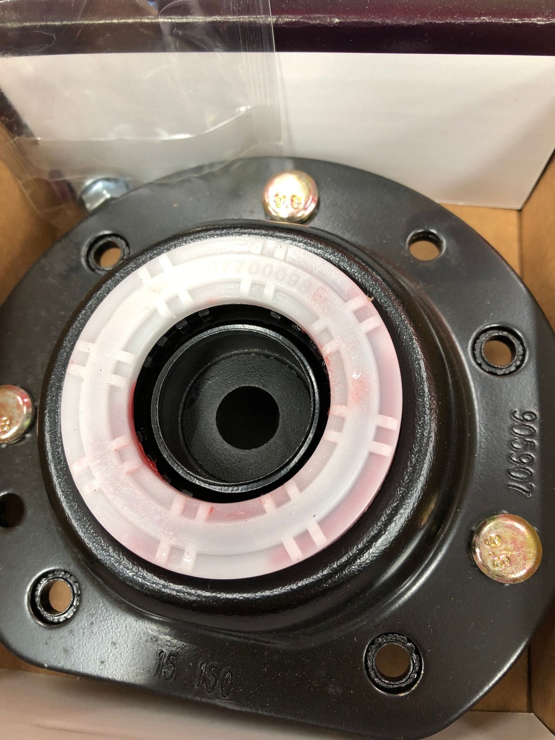

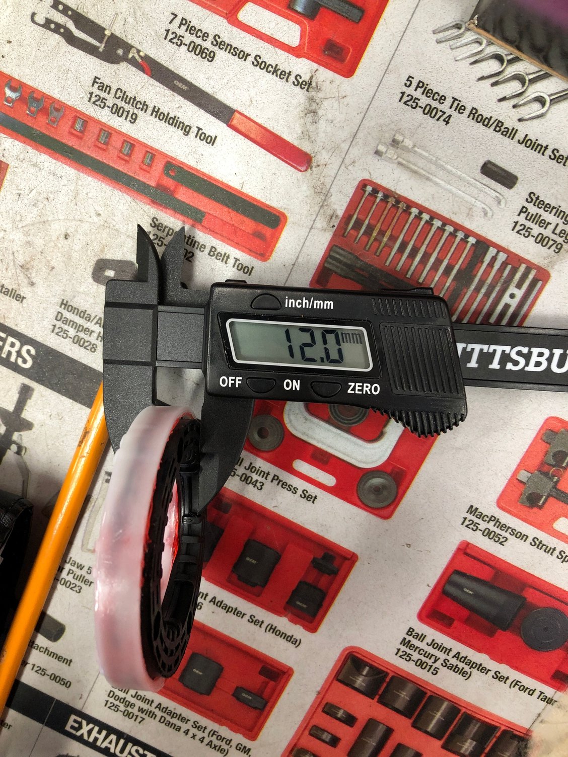

I had to wait until this morning to get the measurements, this is from a Monroe strut mount kit, for our trucklets. The outer diameter 65.8 mm
The inside diameter is 39.5 mm
It’s 12.0 mm thick
This white nylon part has the number 107700098B on it

Dear Oldblue.
This is very valuable. Thank you very much.
Useful for me. I think it will be useful to many site users in the future.
The last picture is very valuable too. For the first time I see the location of the bearing in the frame in such detail.
