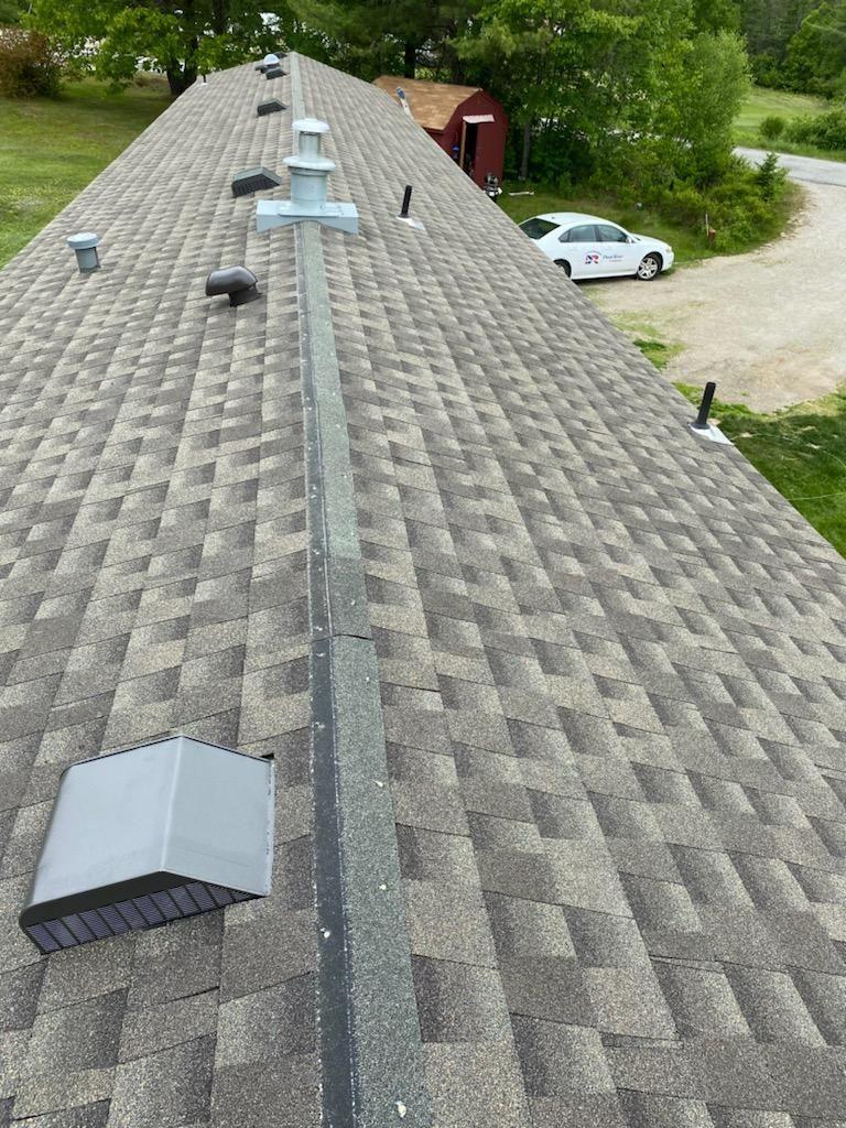

LOL Let me tell you I had aches in body parts I did not know I had after that roofing job lol No more roofs for this old fart lol But it did come out nice !
Finished except for ridge vent
