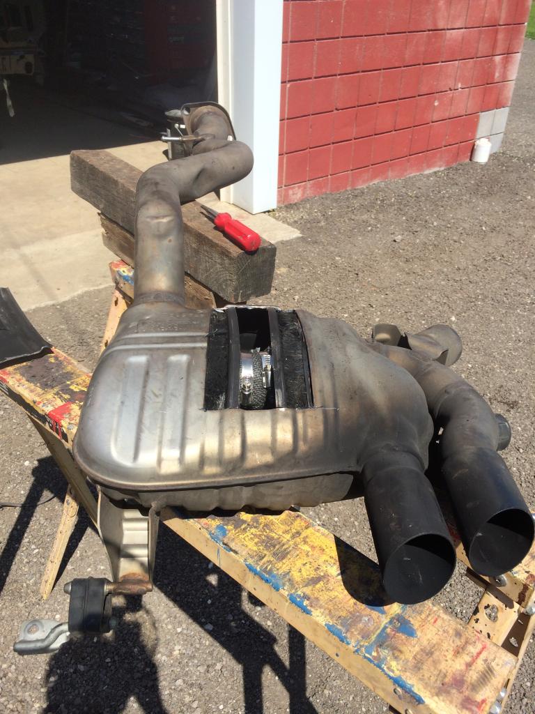

I'm curious if anyone has cracked open a stock exhaust muffler and looked at the internal structure of the piping?
I have been searching for the past couple days and haven't found anything conclusive. I don't have a boroscope or camera of any kind to look down the muffler and curious to what I'll find when I cut it open; looking into modding it with little to no money involved.
I'm a skilled welder and have plenty of SS MIG wire to re-seal. Plan is to cut open and wrap internal piping with header wrap (done it before, gives it a lower tone and slightly louder) and possibly re-packing new fiberglass depending on condition when I find it.

2 Attachment(s)
looking for 2.2L but I assume a 2.4L would be the same? No?
This is what I did on my BMW, looking to do it on my cousins HHR and don't want any surprises because once you go down this road you're committed haha
Attachment 23056
Attachment 23057
Straight through design is what I'm looking for as the project becomes just sealing off the perforations of the interior piping. Gives it a very soft straight pipe sound and you can re-pack the muffler to change the tone. I'd post a video of mine but a straight 6 and a 4 banger aren't that close to be able to tell a comparison I feel
