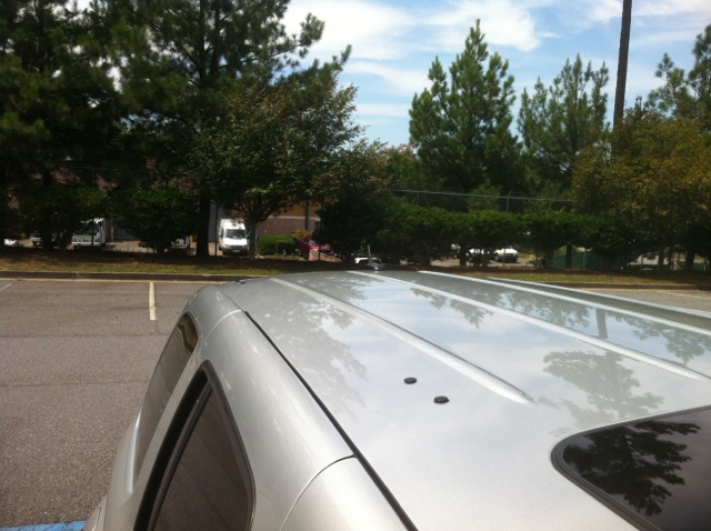

Many cobalt owners have gotten rid of trunk spoilers, Ive seen good and bad jobs done. Proper way is of course welding and repainting. Using filler can look ok too if done properly by an experienced body man, but still needs repainting. Ive also seen plastic plugs and duct tape, but please dont go there...
I've got plastic plugs...looks much better than the roof racks. Sure a full welding job with new paint would best, but $2k in body work and paint...no thanks.
Where did you get the black plastic plugs ?
Did you imbed them in place with a sealant/adhesive or ??
Look pretty good to me from a distance.
Would it be possible to take a couple close ups and post them ??
