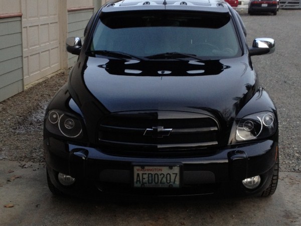

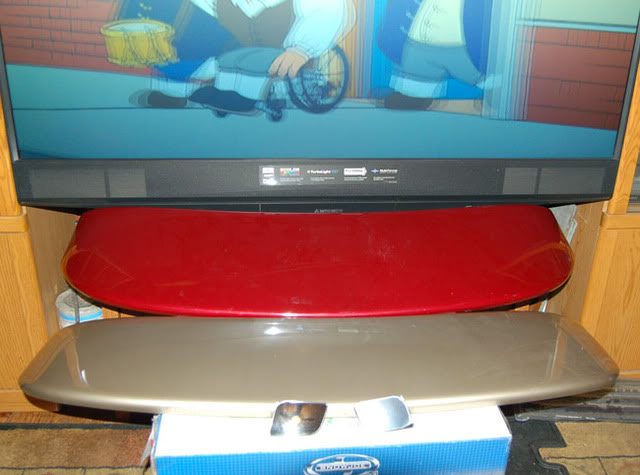

This one was made several years ago, hasnt been made for several years as the custom shop that made them went belly up.
Took me a couple years to locate the 2 that I have and I actively searched for them.

The Visor sits slightly above the roof. 2 screws on each end and a mounting block in the center, that gets glued directly to the glass. You have to shorten the pass. side wiper because of the center mount.
I believe they are made of black abs sheets. My guess would be that the ABS is heated and then vacuum formed over a mold. the same with the center mount, then its abs glued to the underside of the visor.

You got that right, mine has 8 bolts holding it on, 3m tape is not going to do it.

3-m holds this on fine, maybe I'm selling it short ?
