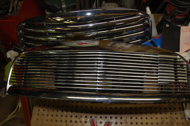

Ok, for those with experience, I am debating on cutting my Black Chrome Grill into a 3 bar grill. My biggest concerns are how to touch it up where I have cut it, or is it polishable?
Thoughts on this?
Thoughts on this?

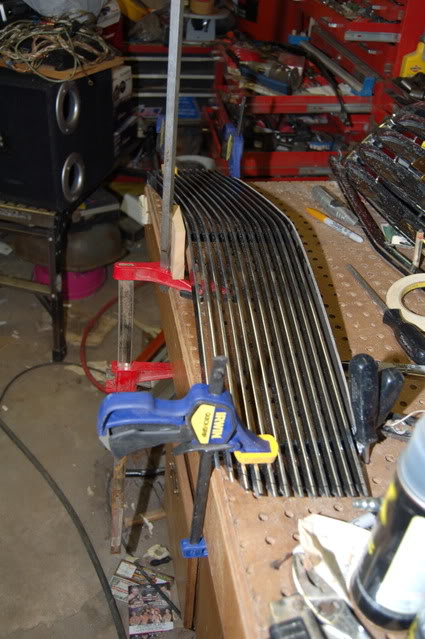

Like Sleeper says, you Gotta Seal the edges you cut or the Chrome will end up Peeling.

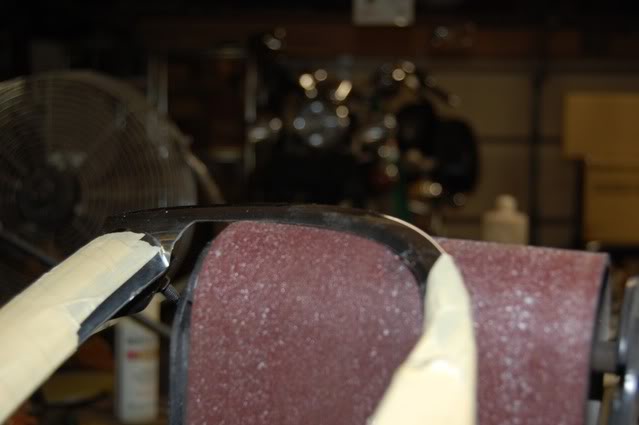

You gotta Try to Hide the cut edges by back cutting/sanding, so the Raw exposed edges won't show as much as possible.
Clear coat the edges as Sleeper said, you can use clear nail polish in a pinch, do 2-3 coats.
You can see here how I am sanding mine so it's Back Beveled to help Hide any cut/sanded areas.

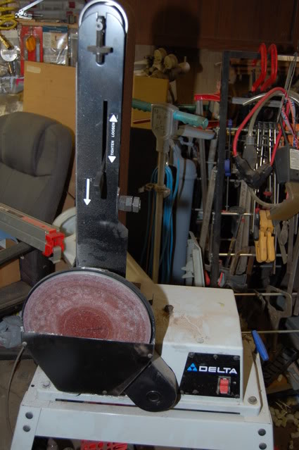

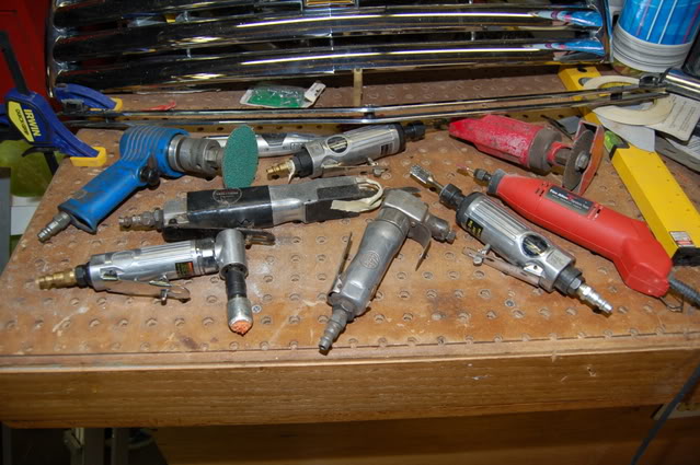

Just a few of the tools I use for modding projects.

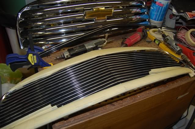

And use MASKING TAPE to Cover your grille BEFORE you even start and use 2-3 layers. This will help Protect the parts you are Keeping from getting Scratched up as you work.
Heres a overall Fit shot before cleaning it all up and installing on my Panel.
I know it's Not a "3 Bar Grille" but it should give you some hopefully Helpful Ideas for doing yours.

A&P thanks for the visual on the "tools"
