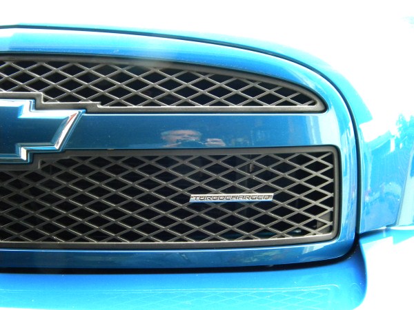

You can cut thru the 3M tape with a piece of fishing line, to remove emblem.
Use it like a saw, back & forth. Then you can buy some 3M at the auto parts to attach to your other grille..
Sam- I see you in the reflection of 'the short bus' grille bar..
