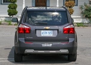

The 4 tail light swap was a popular modification, I always thought a single backup light from an Orlando or dual lamps from a Camaro.
https://www.chevyhhr.net/forums/how-...ght-mod-35862/
https://www.chevyhhr.net/forums/mods...hts-too-28680/
The backup light maybe to large, 2012 Orlando
These 2009 Camaro back lights are just right for either just under the reflectors or replace the reflectors.
A smaller backup single lamp from a 2015 Mustang might work!
