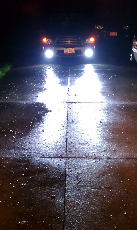

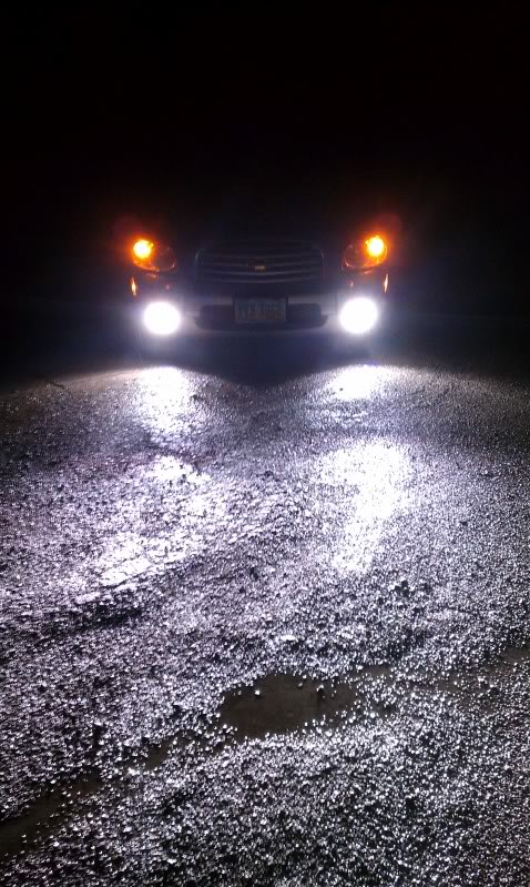

I have a DDM kit. Actually, I have 4 separate ones currently, but have installed 7 total kits. Sometimes you'll get some connectors that fit oddly but I always pull the weather boot off and re-seat it allthewhile adding some dielectric grease to the contacts. I had their Hi/Lo kit on a Cobalt I had. It didn't work effectively with the way the solenoids moved the bulbs in and out-I would attribute that to the reflector housings shape, not the kit.
DDM is getting out of the HID department altogether, last I checked. The latest kit I received didn't even come with an H13 connector. I had to order a set. Kind of upset me but what can you do?
They still honor their lifetime warranties. I'm surprised you acquired a kit so late in the year. They announced they weren't going to be selling them anymore MONTHS ago. I've been out of the loop.
Check out buyhids.com
He is a regular on the CobaltSS.net forum and ALWAYS seems to provide quick feedback. All he requires for a replacement to be sent is a photo of the bad component. He also used to say his HID kits were made in the USA.
I never bought from him before, but I've heard a lot of positive things about him.
His S/N is :mkulrey13
HIDs are lovely.
